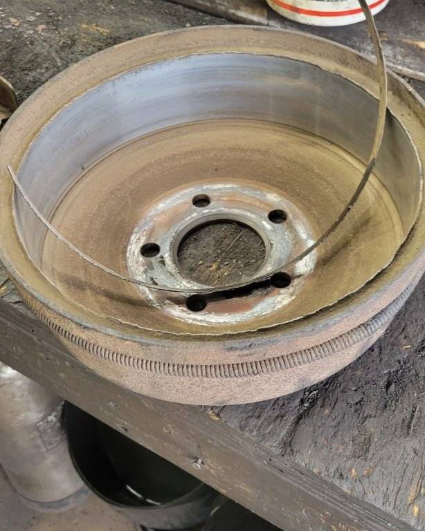

I have been trying to keep the 68 300 as produced. The car was built with 4 wheel drum brakes. A while back while driving the car, I could hear a grinding from the front wheels. Thinking it was a bad wheel bearing, not wanting to lose a spindle, I parked it.
Finally lifted the front end and shook the wheel, no play, but I could still hear the grinding. Took off the wheel, spun the drum, still that darn noise. Pulled the drum and there it was, the edge of the drum had separated and was rubbing against the shoe (see photo)
While in there, the adjustment spring was pretty much 90% out.

photo of the inner edge of the drum that separated
