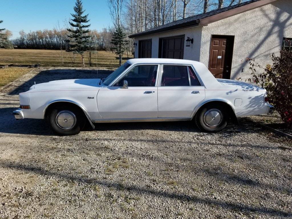

Enjoy the Dippy! Here's my winter beater after I finished the pre winter repairs...got it for $200.00.
