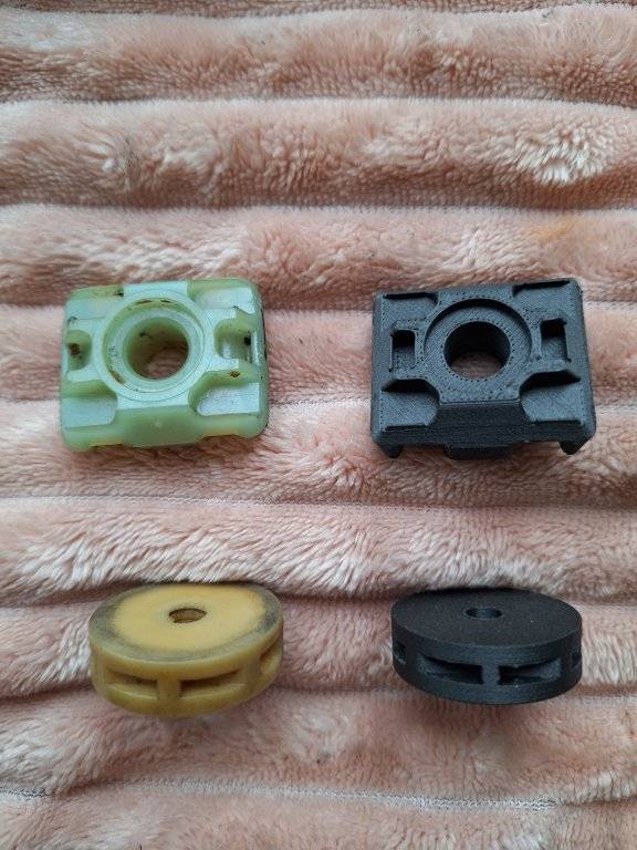

Had those hard to find window "sliding blocks" scanned and 3D printed.
Stargazer
Sep 25, 2019
249
307
the Netherlands
For those hard to find C bodie plastic parts, 3D might be the solution.
Take the originals to a 3D shop and have them copy them.
Are you sure? Looks like ABS.
Did they give you a copy of the design file? (I think usually .STL ?). It would allow others to print them for themselves.
Not sure, but he told me it would be nylon.
No copy. Wonder if he would share that since that seems to be the most work...

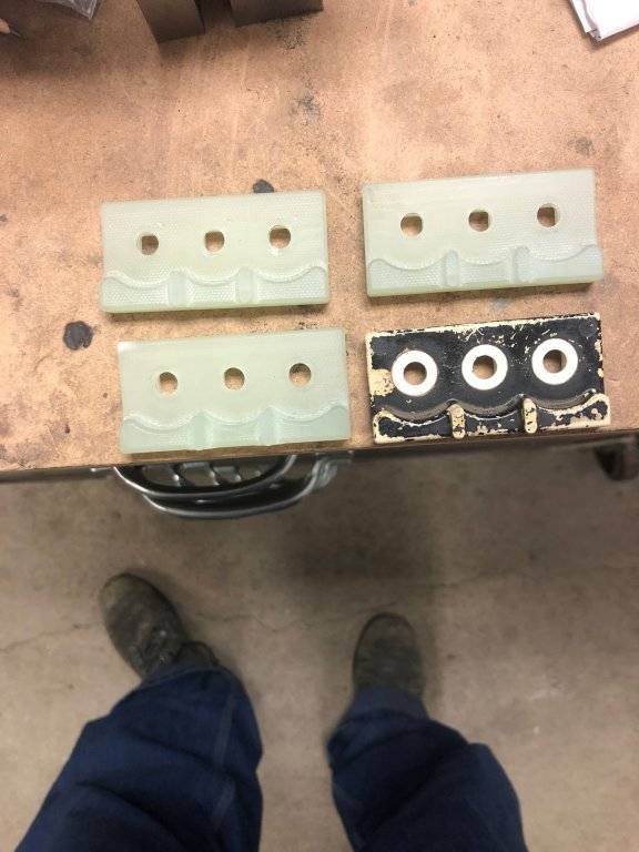

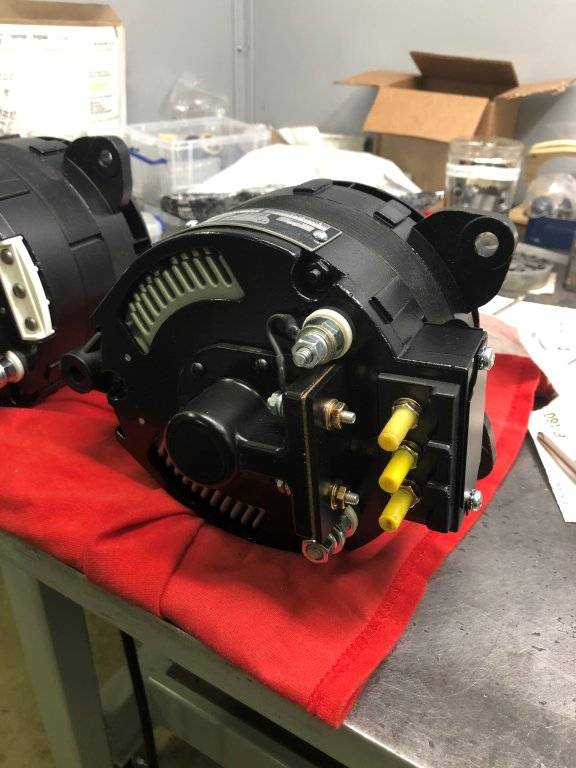

I just can't get past the crudeness and differences of printing for my mopars - yet. I still rather machine. This is what I machined for my 65 Fury cop car alternator. Made it out of G10.
Crazy me would have machined those parts.

It really depends on what it is. The prints are good for what they are. It depends on the type of plastic, and machine settings for both appearance and strength. Most of the home machines aren't good for printing nylon. The usual home machine, like mine, can print PLA or PETG without issue at ~200°C but lack the ability to print at ~250°C for nylon. Then you have to orient the part, so the weaker printed layers don't break.
What they can do is let you easily do a "proof of concept" type model before you start making chips. I made about 3 different configurations of a gauge mount for my 300L in PLA that looked rough but let me fit them exactly where I wanted. Then I did the "nice" version in PETG.
If you want it stronger and want to use a better material, you can't beat machining the part. Although I have to say from back in my toolmaker/modelmaker days, I never liked machining G10.
