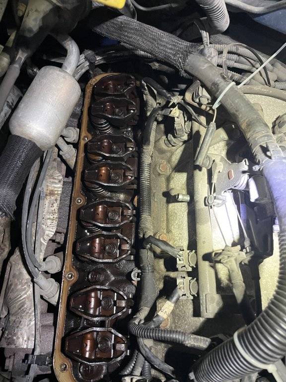

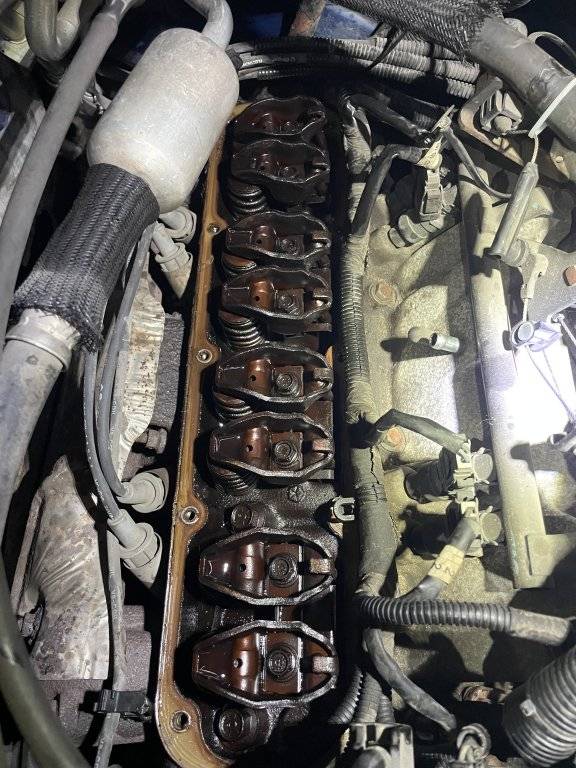

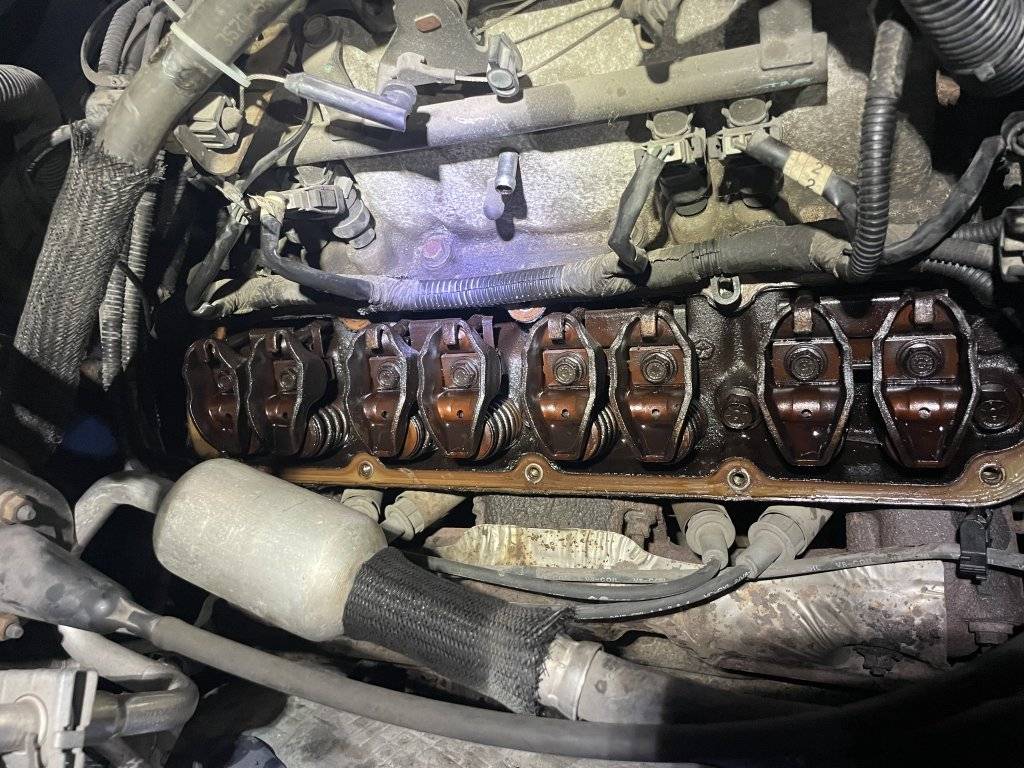

Since I’ll be taking valve cover(s) off any recommendations on gaskets / brand? Has anything like the excellent Mopar trans pans been developed?
Just finished getting the back lower nut/stud out. Rest are broken loose.
Pretty tough to get to. On break now lol
