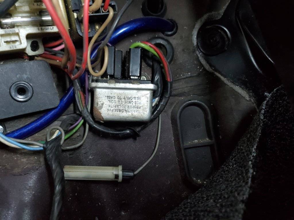

so... the current for the head light does not go through the dimmer switch with the "auto dimming option" unlike standard headlights. Follow the wire from the foot switch and you will find a relay up under the dash. The only reason for low beam to be dead i would think would be an open wire or burnt contact in the dimmer relay not the foot switch if headlight dont light.

His is a 69 which is two or three generation newer than your and is electronic except for the photo tube and will not have the amplifier box as it is all contained in the head unit. All these systems (and the Twilight Sentinal) was made by delco electronics.
I'm thinking this is the relay controlling the beam changer? Purple and green wires are going to the dimmer switch. The FSM doesn't troubleshoot this system. Is there a testing procedure to test this relay?
I don’t have any reference materials here so everything is from memory.
The three terminal connector is for the headlights with the power in the center connection. You could plug a standard Foot dimmer switch in this and have your headlights working. You can also jump the center terminal to either of the outside terminal to test for the highbeam and low beam wiring. Just in case there is a open circuit at the firewall connector for the low beam.
The other two connections are for the coil in the relay, but there is a diode between these
two terminals to prevent fly back. If memory serves me right, between the center pin for the headlight connector and the two wire connector for the coil. You can provide positive to the center pin, negative to the farthest pin on the coil to activate the relay.
Tell us how it goes. And good luck
