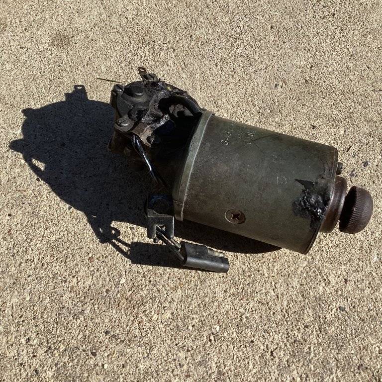

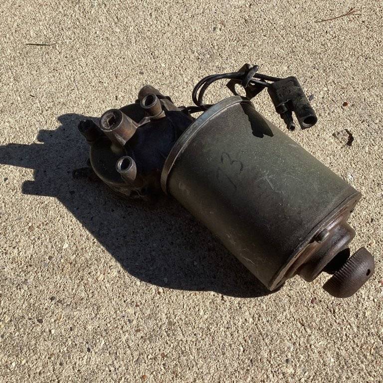

I have a good used motor. $100.00 plus shipping. No electronic payment. US cash or money order. Located in Rockford IL.61109
Hey Alleycat53!

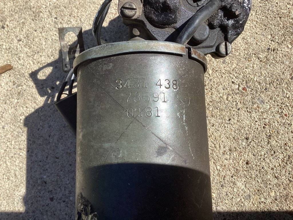

Could you pls post pics with part no.?
THX in advance!
While the motors seem to be interchangeable, different applications had differently shaped switching cams sitting on top of the gear, allowing for different length of travel. These cams can be identified by their color. In a 1972 MTSC booklet the following are listed:
