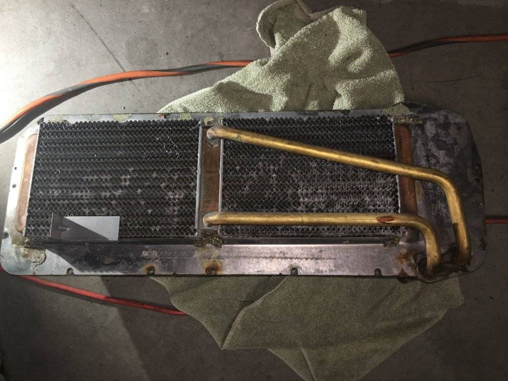

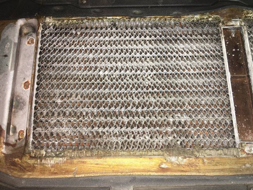

Well, i pulled my heater box this evening expecting the worst. The box itself was disgusting, covered in mouse/rat crap and urine. The inside, however looks pretty good. I'm hoping my heater core is fine. I'm going to take the heater core and my evaporator to be checked out before reinstalling. In any event, I'm glad I pulled it. Needed to be done.

Off to get the heater core checked and cleaned out if necessary at the radiator shop tomorrow. Hopefully the evaporator gets dropped off tomorrow as well.

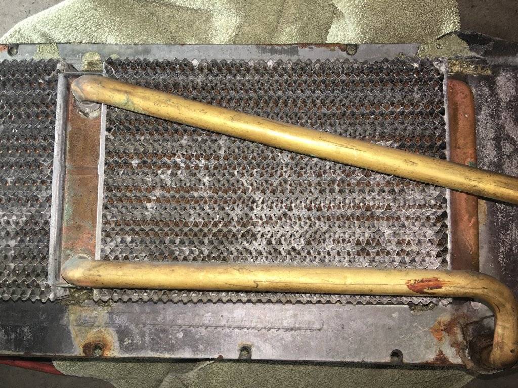

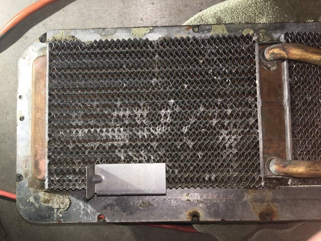

Ouch. Well, just heard back from the radiator shop. Heater core is bad. He attempted to find a source to replace what was necessary, but no one makes heater cores in that size. So, Obsolete Air it is. $304.99 later...and it appears I have a brand new heater core on the way. On the upside, my evaporator is good and he's going to flush that out for me so will be good to go whenever I get my A/C set up.
