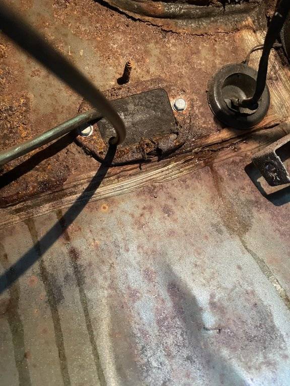

1972 fury I ordered 2809041 cable it said it would fit a AC car. It seems to me my cable is about 1 or 2 inches short no matter how I route it. It enters the interior far right on the firewall. I’ll post photos in the morning but am I messing something?

I see, this bring into light my other problem the previous owner seems they didn’t like that the blower was always running either so they hacked up the ac/heat harness. The cable I took out was also a one piece so maybe they swaped that out, I also saw somewhere that the heater control valve on 72 was plastic but mine is a metal one.
The earlier vacuum-modulated water valves were plastic, although the replacement industry had some metal versions. The cable-operated valves were all metal.
What I did on our '72 was to move the heat lever just past the click and reset the water valve to closed, with the heat lever in that position. Worked well, just looked funny. But you could reset the level to cold with just a bit of a pull. Then reset as needed.
