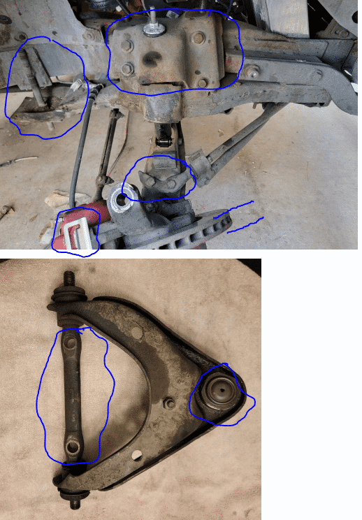

Although it has a 41 front clip it is a 46. The old boy that had it for 52 years really put it through some changes. I got a file of receipts, notes, and repairs he'd had done. He mentions 69 Fury iii in the notes. I'm attempting to rebuild the upper control arms and the parts don't match that model. Now I have a mystery on my hands.
Not many. The numbers off the disc brake calipers led back to a 5th Avenue. This is what I'm working with, if anyone recognizes it.
Thats a real hodge podge of parts.. Looks like 74-93 dodge D100 d150 truck strut rods brakes and spindles, van upper control arms.. c body sway bar hangers. That'll be fun sourcing parts.
Thanks RD. That tells me more than I knew. I've tried 3 different part # upper control arm bushings. The OD has been different. 2 sets with the same part #, one set would slip easily over the connecter rod but the other wouldn't. Crazy. smh.
