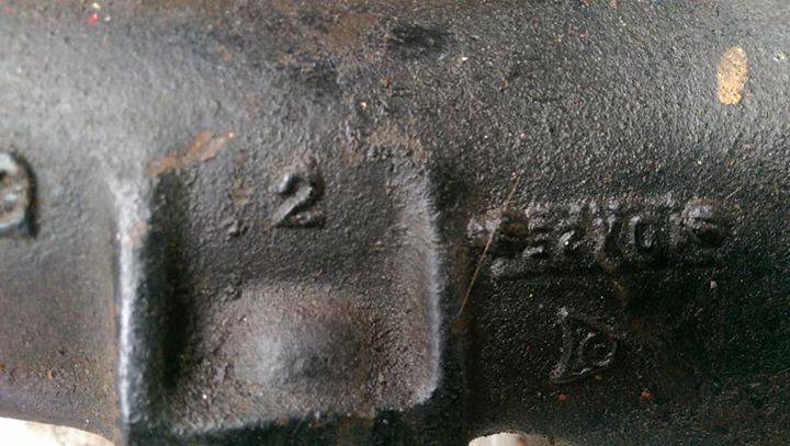

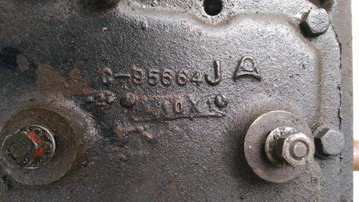

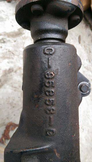

Hello,
Can someone help me ID this A833 manual trans ?
Thank you.
I'm no expert, but based on where the shifter mount is and the "ball and trunion" u-joint flange, I'm pretty sure it's an 1964-65 A body trans.
I think there were two versions, one for a six and one for an 8 cylinder car.
BTW, the plant were they made these used to be here in Syracuse. They closed a few years ago.
I looked around a little and I think I'm incorrect about a 6 and 8 cylinder version.
Should be a 3.09:1 first gear ratio, but you'll want to verify that.

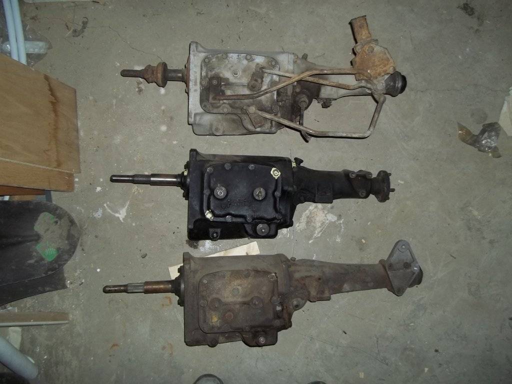

I would use a B body or a B&E body like the bottom one in pic above. Will make the shifter come through the floor on the right spot on a actual c body.
