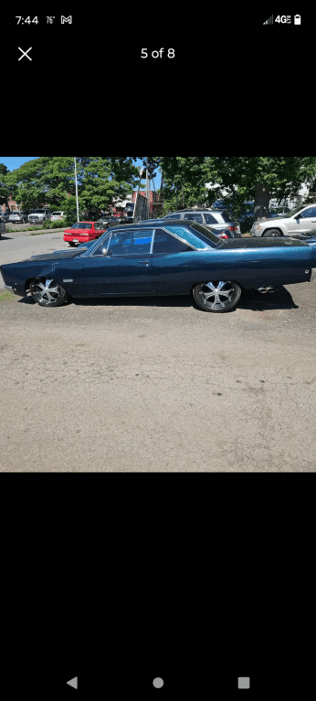

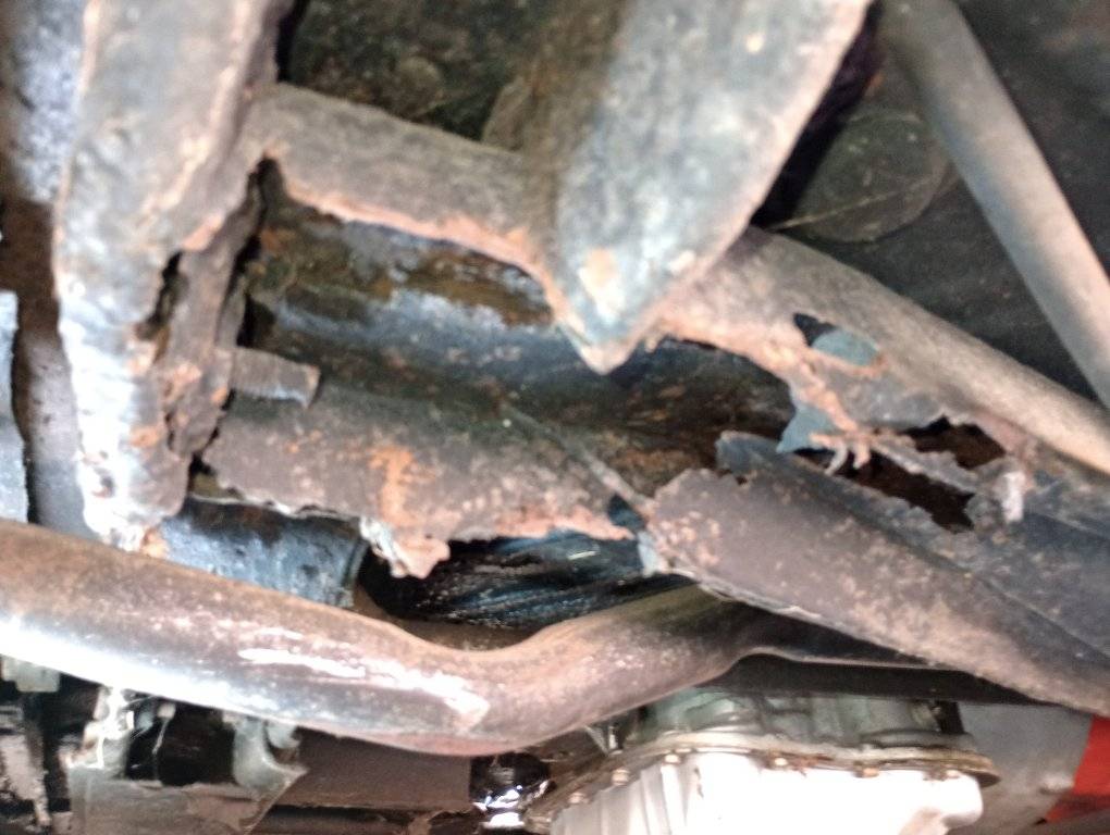

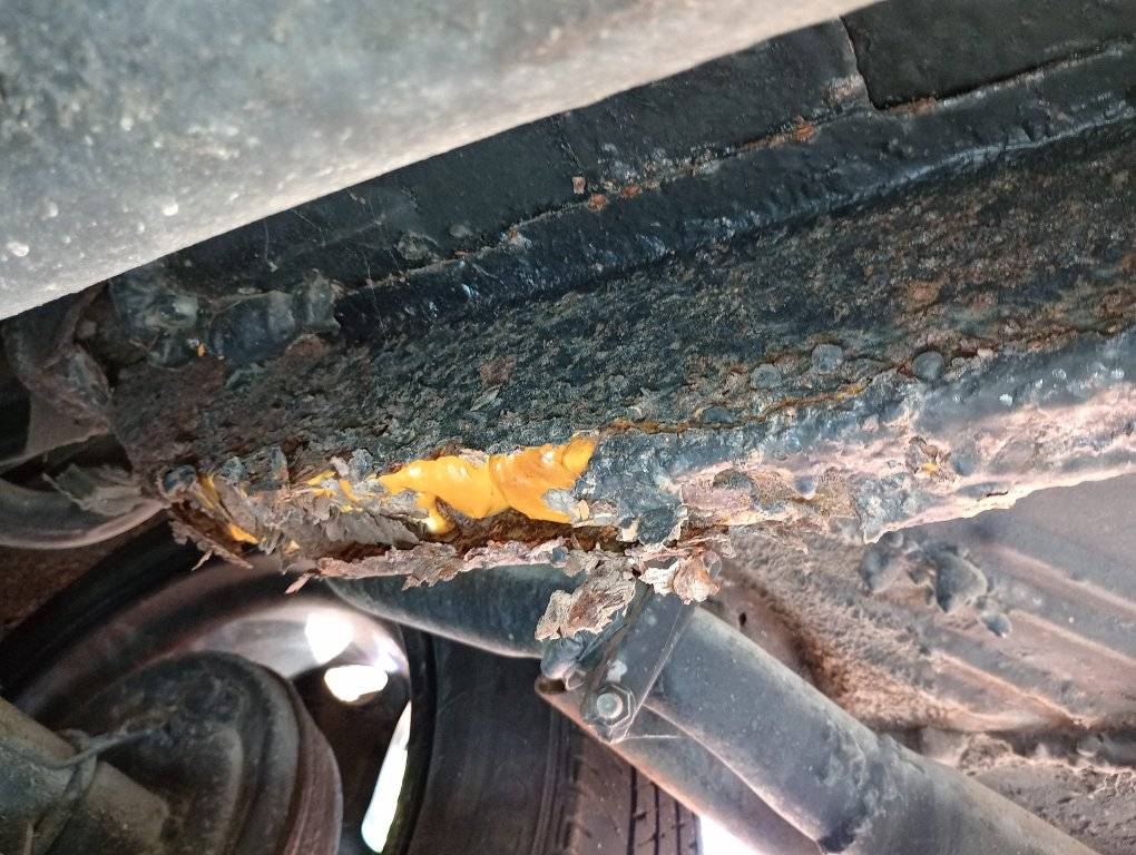

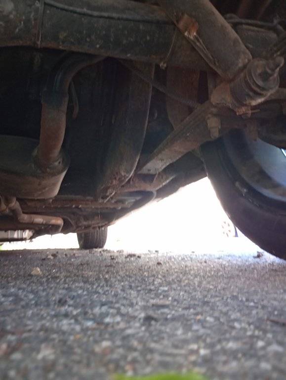

Not sure what u mean but here's some pics
Yikes! That car is going to need a lot more than a front stub swap and rear rails. When the rust is that bad that it ate through that much of the front stub you can bet that the mounting points on the unibody are going to need a lot of work too. In my opinion you have your parts car now go find a solid body.
