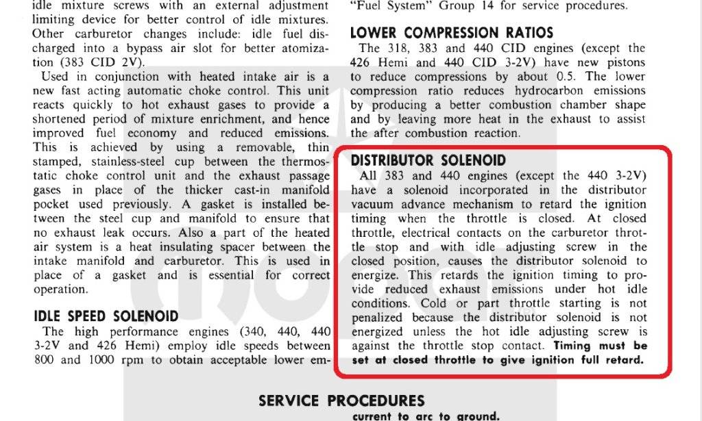

This is from the Factory Service Manual for a '71 Plymouth, which will be basically the same for a '71 Chrysler in a lot of areas. I strongly suggest buying either a used paper copy or an electronic version and you can find those on eBay. For the moment, you can download the '71 Plymouth chassis and the '71 Dodge body manuals to get you started. Service Manuals – MyMopar Unfortunately, they don't have a '71 Chrysler manual to download.

The solenoid was part of the emissions package that retarded the base spark timing at idle. Once off-idle, the ign was advanced to normal. Most of the solenoids failed with time, and they were NOT replaced, usually.
If you remove the wiring and contact at the carburetor plus the wiring to the distributor for the solenoid, it'll look "stock" as a 1968 situation did.
If you feel you need the solenoid for cosmetic reasons, just transfer the unit to the new distributor. Easy to do. Just a few screws inside the distributor. Make sure the old unit holds vac, though!

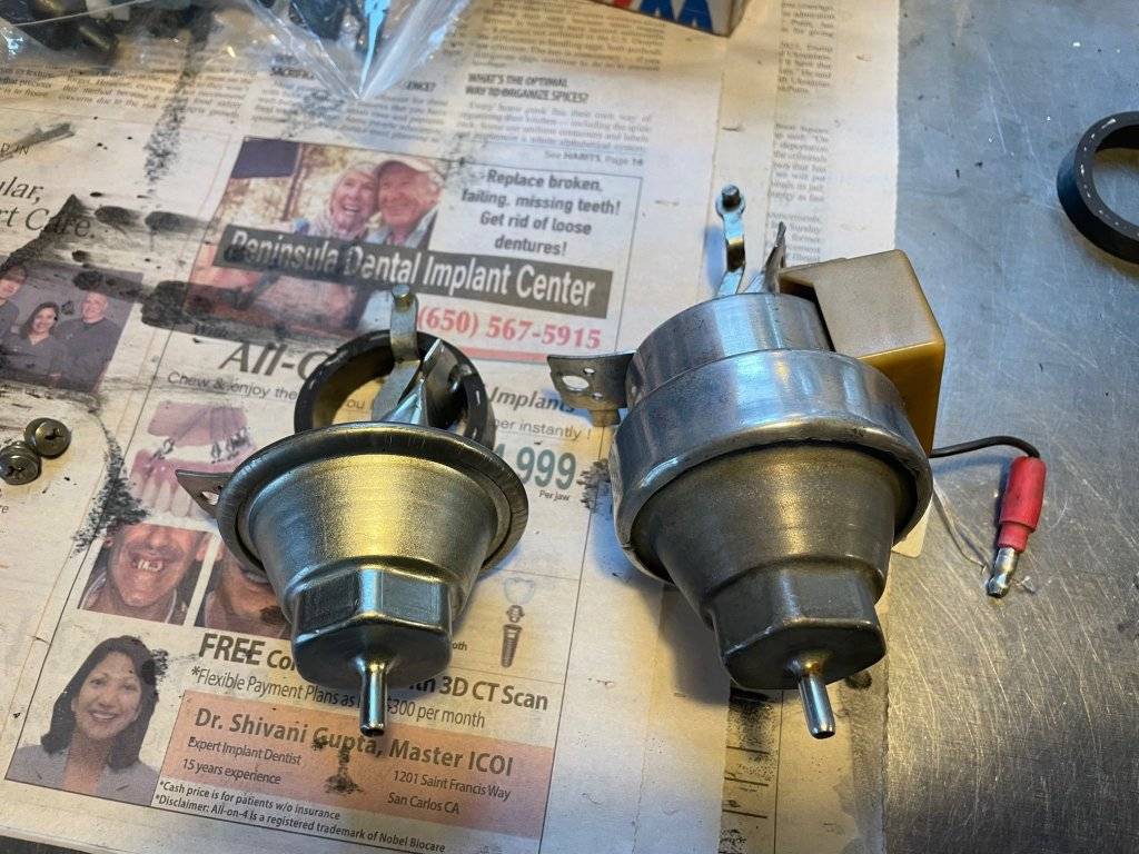

I got rid of the heavy and clunky "retard solenoid vacuum advance" on my 71 and replaced it with a normal vacuum advance from @halifaxhops . Now, it looks better and there's a lot more room around the distributor.
