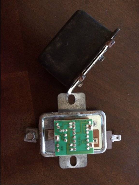

voltage regulator?
So I ended up taking the fury down to advance auto and the guy hooked it up to some tool and told me the voltage regulator was shot. I pulled the old one off thinking if it was original maybe I could clean the points and get back on the road. Once I opened it up, I discovered it was an electric/solid state unit. So.... I ordered a replacement from RockAuto and it came in today. I cleaned all the connection points, hooked it up and still have the ammeter bouncing all over and can't get lights/ac/radio to all run at the same time. The ammeter drops way down and the radio cuts out, lights dim, etc.
It looks like it's the A/C that is the big draw on voltage. I was hoping this group might have a suggestion? Alternator? Back to Auto store for another reading?

Sounds like your alternator can't keep up at idle. Works ok at cruise speed? You need to check the voltage output at idle. Most old alternators were only about 50 amp max and only charged about 10 amp at idle. They are not like modern alternators that put out 40amp at idle.
Ok, yep things work fine when driving, but it's at idle when the voltage drops. So, it sounds like a new or rebuild might be in order.
Is yours a single or dual field alternator?
With that voltage regulator on the picture it's the "single output" alternator (actually both the single and dual output alternators are single field alternators).
