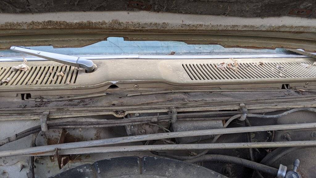

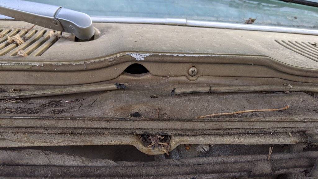

Hi everyone,
I'm hoping someone can help me with a question I have on the windshield washer tube routing for my '68 Newport. The tube that runs to the passenger side is either cracked in two right near the center of the cowl or I'm missing a "T" fitting or something. This is my first old Chrysler so all this is new to me.

It broke. Take a sample of it to the parts store and buy enough to replace the entire section. You may want to replace all of it all the way back to the washer pump / bottle.
Be careful with the divider block on the far left hand side of the cowl, where the line from the pump makes the the 90 degree turn and becomes two separate lines, one for the lh and one for the rh of the windshield. It's white plastic and small, which also means fragile. But I believe they are in repro as they usually cover many Chrysler vehicles. Might plan ahead an find one before you do that line replacement, just in case.
Enjoy!

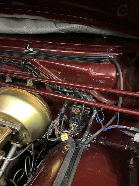

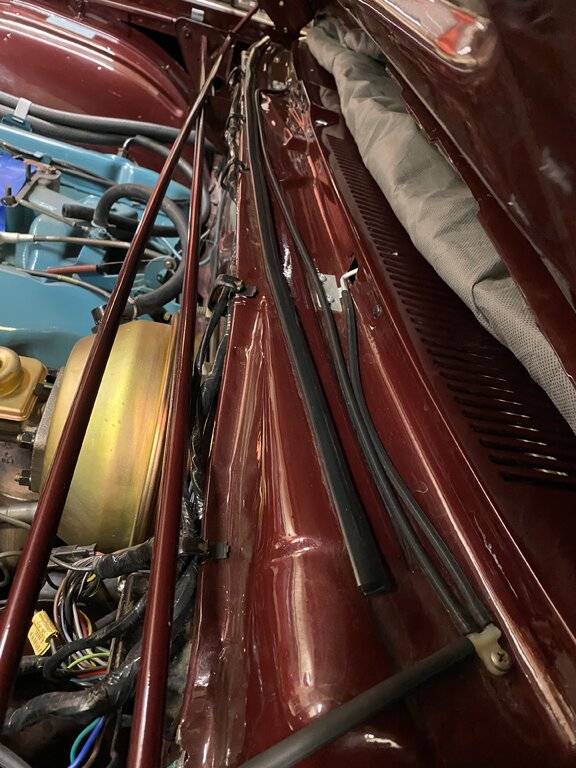

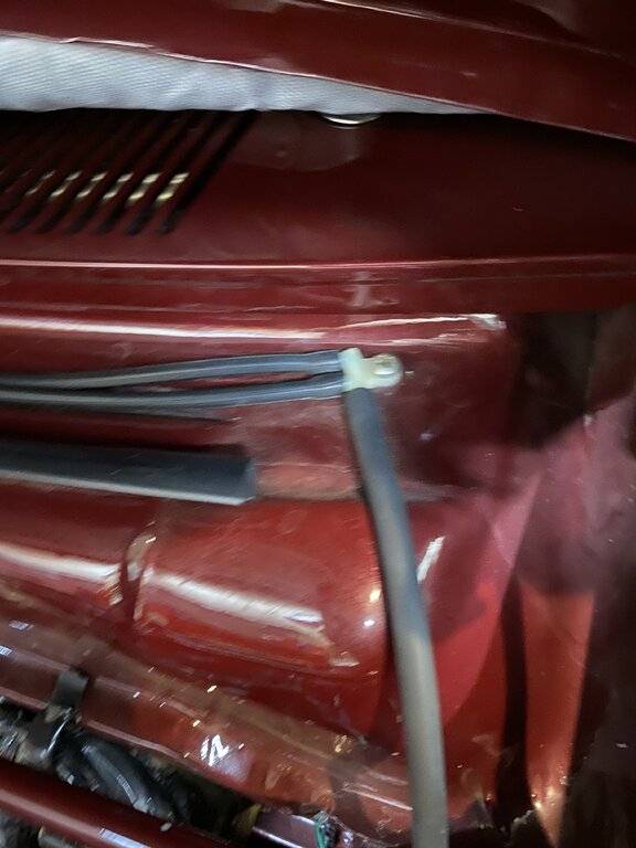

Your hose should go from the pump to an "F" fitting on the driver's side just behind the hood torsion bar, and then there are two separate hoses going to the nozzles.
Thank you so much guys! I suspected that it was routed as you all said but wanted to make sure. The pictures were really helpful HWYCRZR, thanks. I think I'll try and find that F piece and just replace all the lines while I'm at it.
