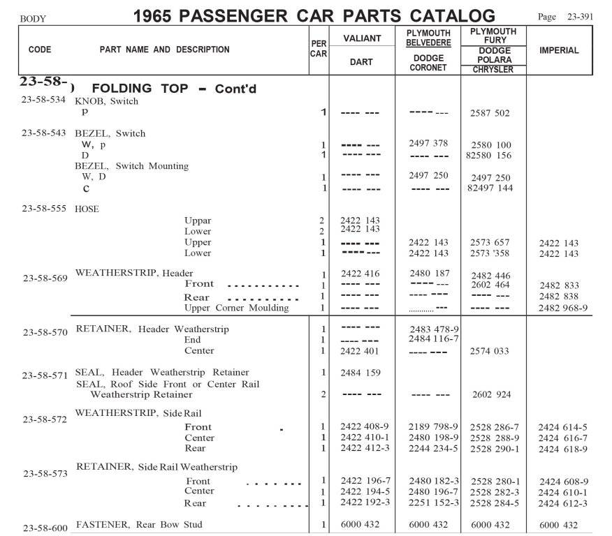

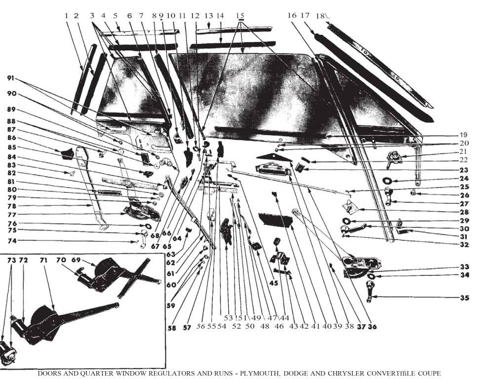

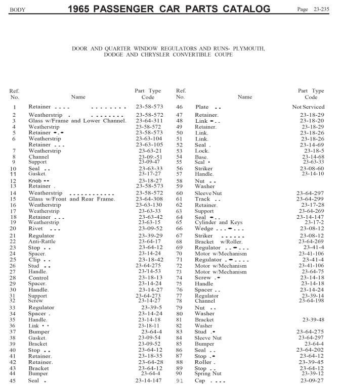

You mentioned "tech manuals", what about Chrysler parts books. Even if you find something in a year different from yours, the "group number" should be the same for all years. With that information, it might be in plain open sight in the '65 parts book.
Just some thoughts,
CBODY67
Here are images I've exported from the 65 Parts Catalogue that might show the parts you're describing:
Convertible glass, run channels & weatherstrips and their numbers on the parts list
List of part names and where they're found in the book - I believe you might be talking about parts in the list #s 1 and 2
As you can see, their code is 23-58-572 and 23-58-573... weatherstrip and retainer
Part numbers in the part code area of the book that deals with the weatherstrip and retainer found at the back of the rear 1/4 glass.
You would look for 23-58-572 and 23-58-573 in the left hand column, and then move over to the column that supports your particular car - in this case, the 3rd column - Plymouth Fury, Dodge Polara and Chrysler, and look for part numbers. Part numbers are Left and Right if there are a pair (one for each side).
Hope this helps

Thanks. It looks like I am after #86 on the picture which is 23-64-202 which is a seal, both sides but the page for that is different than the one you displayed. I don’t have the book you have and my manual does not display them. Given that, where and how would I procure those? They are very thin and so weathered, they basically crumble. After looking at 2 65 SF’s at a salvage yard this morning, not something I can make?
Part numbers 2573 776 and 2573 777

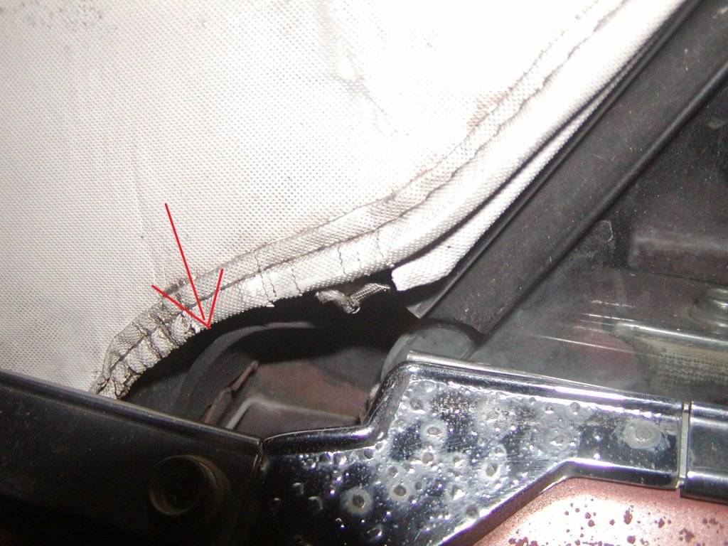

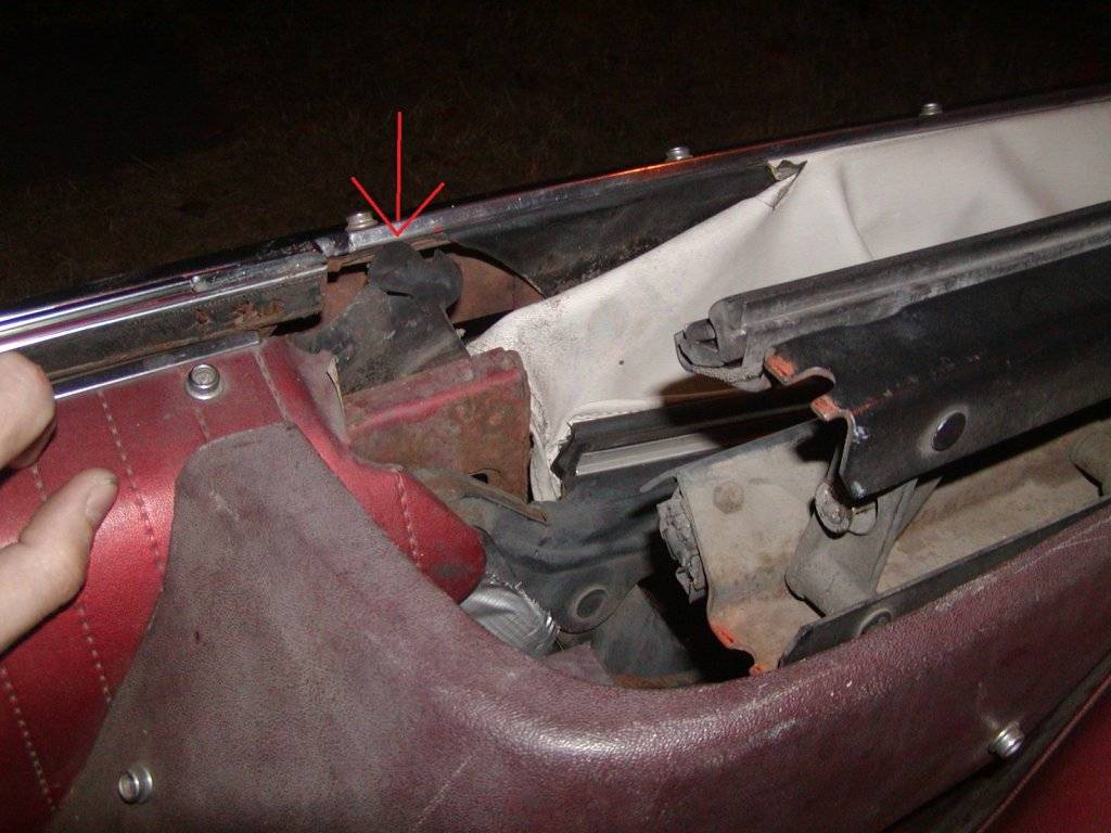

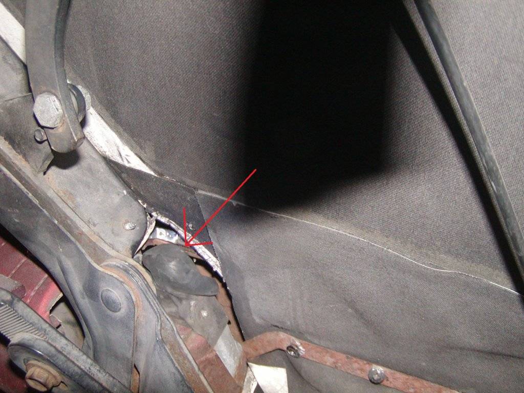

I actually don't remember that seal #86 from when I was working on the rear windows in my convertible. Does it attach to the top of the rear window channel, #78? Is it visible from above when you roll down the rear window and look down inside the opening from above?
I had a problem in that one of my rubber down-stop bumpers #85 had disintegrated. I couldn't find a reproduction anywhere so I cut one out of a large chunk of black rubber.
I believe this is the part. When the top goes up & down, the bottom edge of the vertical window channel brushes against the seal and probably causes them to fail with age. It is a pretty complex shape, so would be tricky to make a new one.
Your right on with regard to the seal I am talking about and your top picture is exactly what mine look like! Need to be replaced but being it is a molded, shaped piece, not sure how to address if I can't find a pair to buy? Thanks for you in
