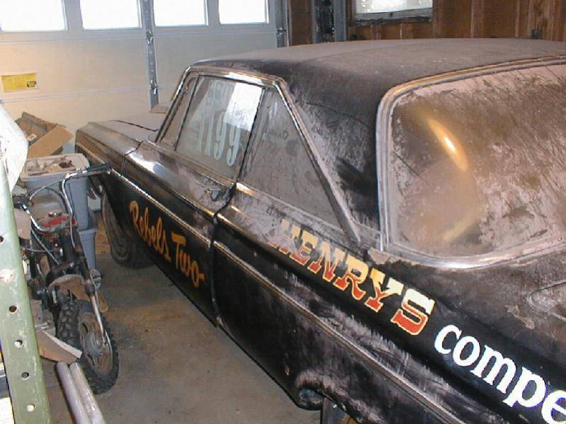

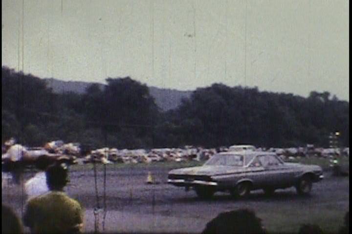

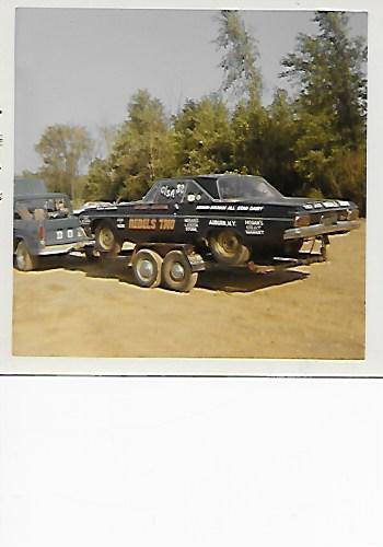

Hello,
My name is George and I'm looking for information on this grey 1964 plymouth belvedere that raced at Utica/Rome, Esta, Fulton and other central NY dragways by Herm Schremmer. In 1970, it was painted blue and labeled the rebels two by Koy Lilly and Basil Kester. Please excuse the fact that it is a b body. Thanks

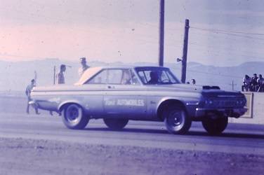

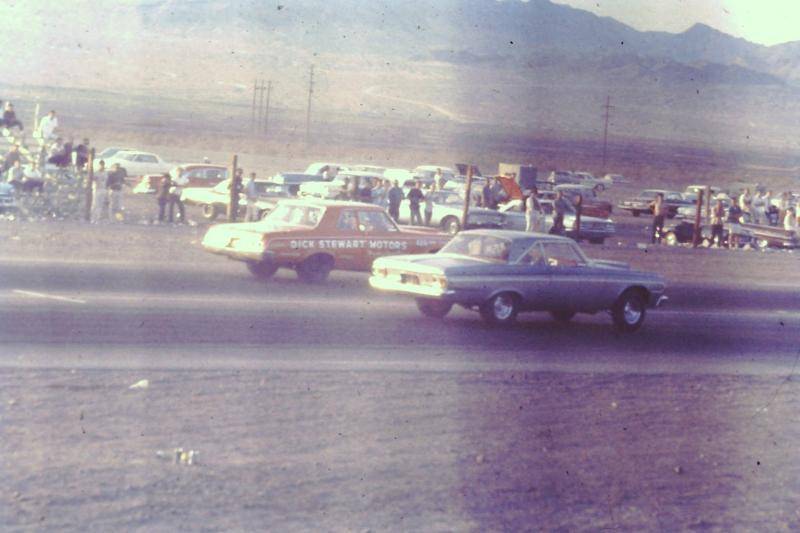

It will be restored back to factory race conditions with upgraded parts. My father coined it as a continuation car. It was originally a 4speed and Herm put in a period correct 727 auto all tricked up. cheetah valve body reverse pattern real slick. Apparently Herm was the auto. genius. But, were putting the a833 4 speed but with a 65 alum. race hemi 4 speed with lakewood scatter shield. we do have the original steel 4 speed and bell housing. The car came updated with a 69 1/2 dana 60 sure grip with 5.13 gears which will stay. Racing Torque thrusts for the rear(custom fit) and steelies for the front Were not going back to the 8 3/4. The engine is a complete stage111 H.C. balanced and blueprinted. All period correct build dates. We have updated the oil pump,pan and ignition systems. Hookers headers that sweep under the car instead of the cast iron headers. Besides those mods, we are trying to keep it close to original as possible. I located 2 original pictures of the car which was from Nevada originally.

I found this picture a few weeks ago. Its the origin of this car. Notice the torque thrust rear wheels and steelies in the front. We set it up like this before we found this picture. 15" all the way around. I found a set of vintage 15" steelies for the front.
