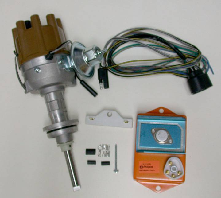

I am planning on changing to an electronic ignition on Goldie. I had 2 failed condensers this summer and ready to convert. Mancini racing makes a good set up that has a factory look, but has a big orange control box. My question can I extend the leads of the control box so I can hide it out of sight.
I don't see a problem with cutting and soldering the wires back together with extensions. Where do you want to put the control box?

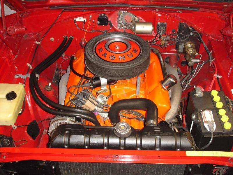

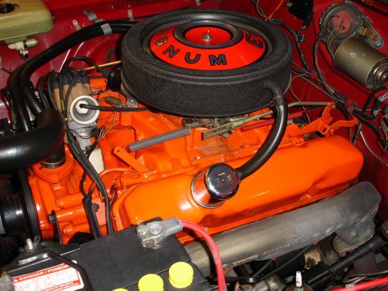

I did this mod on my 69 Super Bee...Under the battery tray and run the wires along the negative battery cable and tape or mini zip tie them to the cable . it was pretty stealth! DSC00311.jpgDSC00312.jpg

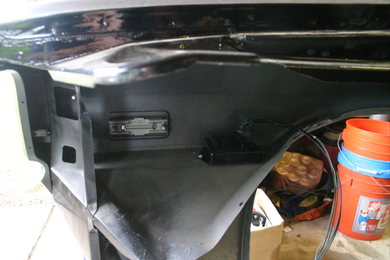

On my CHP car I put it in the fender...

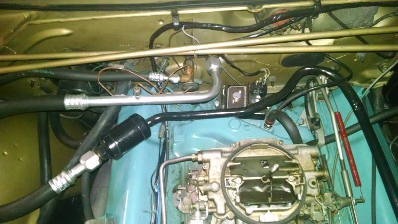

On my Other Polara (a 318 car) I just put it on the firewall...

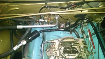

Here is where I put mine. Its mounted to a bracket that mounts directly to the valley pan clamp scrs. No drilling and you need a bloodhound to find under the air cleaner. Found the bracket on Ebay. No cutting or splicing worked out great.IMG_20151217_202822413[1].jpg
Here is where I put mine. Its mounted to a bracket that mounts directly to the valley pan clamp scrs. No drilling and you need a bloodhound to find under the air cleaner. Found the bracket on Ebay. No cutting or splicing worked out great.View attachment 66315
Great idea but how does it handle the heat from the engine in that location? Is that a factor with this type of mounting location? Asking because when I turfed the lean burn on the Doba and went with the Mopar control box I seem to remember the instructions having a caution about heat.
Bingo. Heat. First thing that I thought of. Not good.
