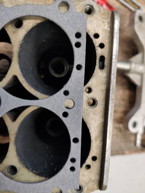

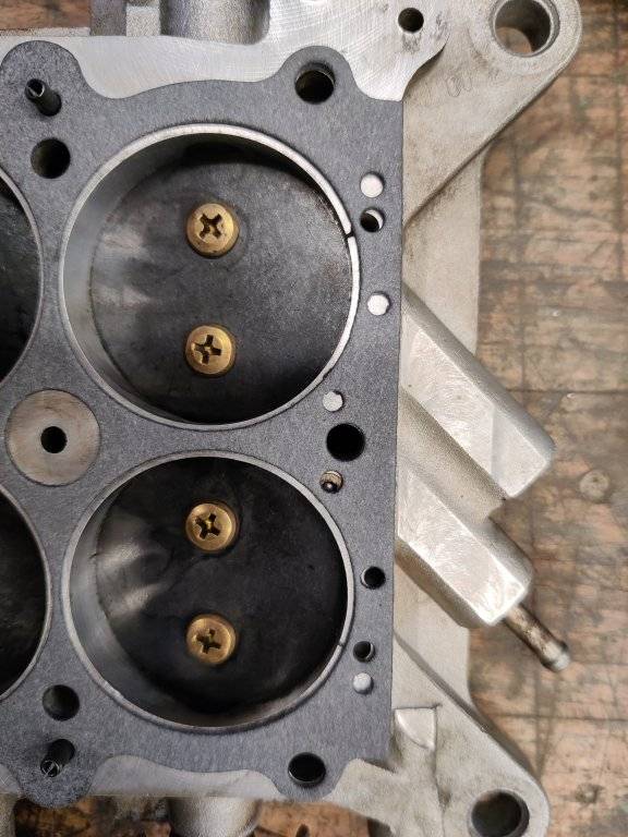

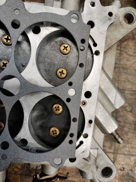

But it looks like they've supplied the wrong throttle body gasket. This is the only one of the four included gaskets that remotely fit. But the right top hole as seen in attached pictures is incorrect.
When I look at pictures of the 37-485 kit it should have a gaskets where the holes are correct.
Is this the wrong gasket?
And am I correct that the holes that are covered by the new gasket are the idle corner holes?
Edit: I took another look. My gasket has 1-11/16 holes.
They have included 2 exactly the same gaskets with 1-9/16 holes, one 1-7/16 holes and one with 1-3/4 holes. Seems that the one I need is not in the kit...
Seems like a packing error. Which I also had woth the holley throttle adapter. That was missing one of the screws. Both adapter and carb renew kit in sealed packaging :(

I wouldn't be concerned with the slight oversize of the gasket versus the throttle bores.
Where it does not match the small vent ports bothers me. Unless, it can accomodate the holes resized.
Did the old gasket leave those holes uncovered? Sometimes this stuff is goofy, like head gaskets that cover some of the water jackets
That gasket is for an 850. Will not work for a 750.
My trick kit came with 4 base to body gaskets, there are 2 like the one you have and 2 that have the angled holes, the one that fit my 4779 was the larger bore with the angled holes, that gasket is wrong.
My $.02
My $.02
