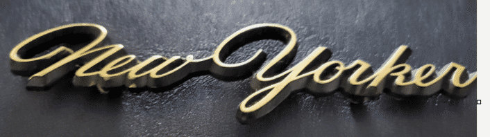

How did the factory get the black paint on the sides of emblems, trim pieces, grills, etc. without getting it on the face or the back?
As an example, this New Yorker emblem below. How did they mask off the face so perfectly? And there's no overspray on the back side either. The only way I could see would be to have a mask that's the exact shape as the piece's surface adhered to it. But it seems like that'd be a tedious manual process back then.
And what is this plated with? Brass? I can't believe it'd be gold. But brass tarnishes, doesn't it?
I could imagine that they had some sort of template that they pressed against the face and then a quick dusting of black paint. I sprayed mine all black and then took a rag soaked in lacquer thinner wrapped around a little piece of cardboard and wiped the shiny surface right away. Did this for all my emblems and trim that had the black accents.

I'm not sure how the black is painted, but the emblem itself is anodized aluminum. The aluminum is cast, polished and then anodized.
BTW, most all of that stuff isn't made by Chrysler and from what I've seen, there's more handwork done then you would expect, especially 50+ years ago. It could have had a die cut mask applied and sprayed. Possibly, a liquid mask could be applied to the face, the emblem sprayed, then cleaned. That could be done with some reasonable efficiency.
The place where I really noticed the hand painting was on the sides of the hood letters on our '66 Newport. Definitely not "sprayed, masked-perfect".
Great info! That's what I was really after, not how to do it myself, how they did it as a matter of curiosity! And I think you may be right about it being aluminum rather than pot metal. If it was pot metal I'm sure it would be blistering, but it's not it's perfect.

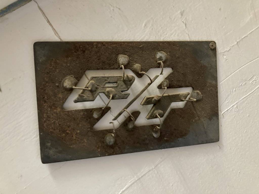

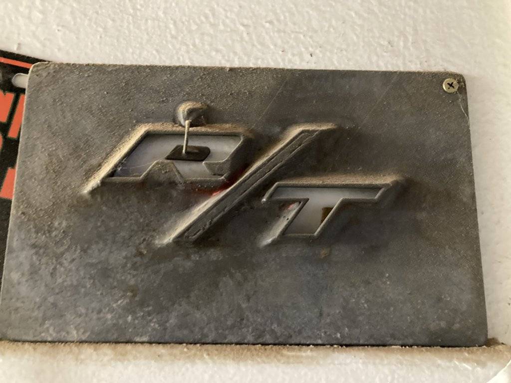

These are actual paint masking templates from the original process. I can’t say that every different emblem had similar templates but I would find it hard to believe that there was much “hand brush” work even back then.
View attachment 701220View attachment 701221

I can’t say for sure if the company that these came from were actually manufacturing the emblems for Chrysler or if they were just painting the emblems that were supplied by others but I’m guessing that they did them soup to nuts.
