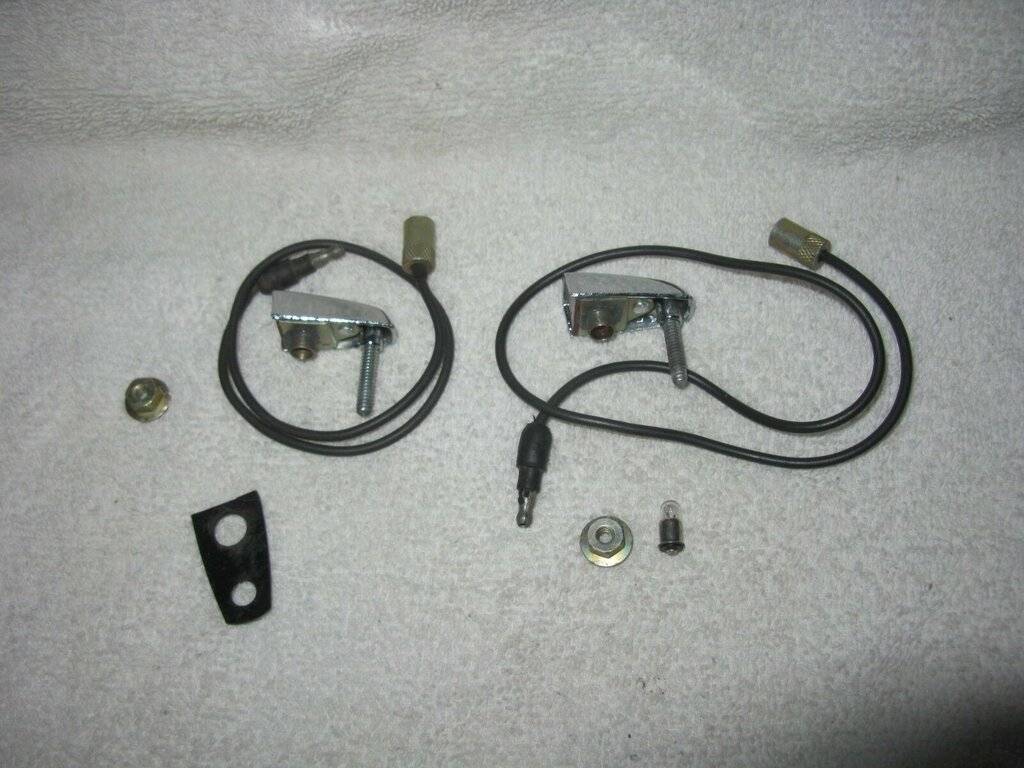

This is a 69, maybe the same?

pull it out from underneath first, then, press down on the bulb a bit, then twist. I recommend LED replacements, but shop carefully for them! You can even patch a little LED tape just below the chrome on the side, using superglue and Clearcoat to hold it in place, making a nice little sidemarker working off the turn signal indicator. These can be had for about $4....

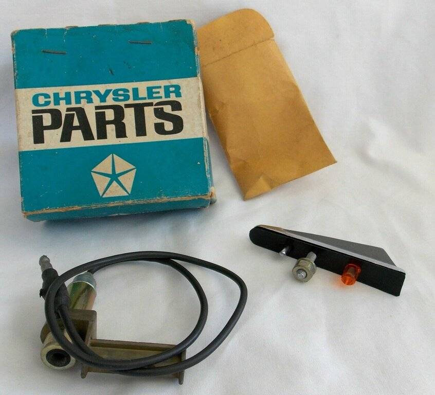

WARNING - the amber plastic part that the bulb socket slides over (you can see it poking out of the chrome piece) is extremely brittle and will snap as soon as you look at it, especially if attempting to pull the bulb holder out of the bulb socket from underneath. Yes it's designed to be changed that way, but I suggest the following instructions to allow you to access the bulb and socket with less chance of damage.
If you're able, spray some penetrant over ther lower assembly to help free up the nut.
Step 1 - disconnect the wiring connector.
Step 2 - undo and remove the nut from the lower assembly. Try to support the assembly underneath as you remove the nut so it doesn't move sideways or twist. Very gently pull the entire lower assembly straight down off the amber plastic. Any sideways movement and the amber lens will snap.
Step 3 - the chrome housing and lens will now also be able to easily come off the car.
Carefully clean the threads of the retaining bolt and put a dab of grease on it for reassembly.
The bulb socket is now more easily gotten hold of, and can be twisted out of the bulb tube on the bench.
The bulbs are available, so that's the easy part, but I recommend you test the bulb, as often the bulb socket is so corroded as to require a good cleaning abd the bulb is still OK.
A little bit of grease will help things go back together easily.
If the amber is broken, you can try to glue it with Super Glue - just remember that any glue will reduce the amount of light that can pass through the lense, so use it sparingly.
Good luck!
