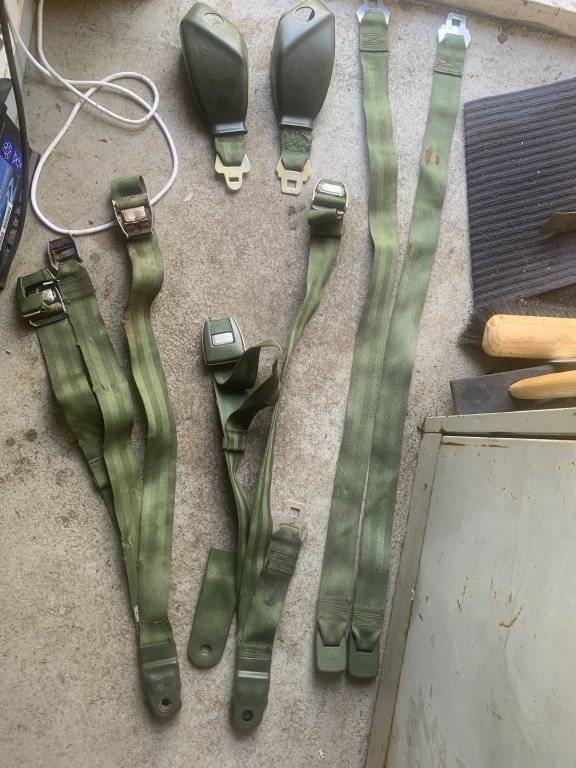

A message from Amsterdam. I have a Chrysler imperial 2 door 1971. I am also looking for original green seatbelt buckles. The plastic has become brittle and 3 buckles don’t even have the plastic cover at all. They are very nice green with a white line.
I am wondering, did you succeed in finding replacement buckles as nice as the original ones? Everything to do with interieur plastic ( in my case green) is hard to find. I thought of 3D printing . Printing is not the problem but making the drawing is very hard to do….
Do you have any leads for a replacement?
Sorry I missed your post, Jet. I am in more trouble than ever. The guy I sent my belts to for overhaul has disappeared. Now I am minus the belts.
Someone on the Pinto forum was soliciting intact plastic pieces to scan to reproduce via 3D printing. I can understand how this could be done on smaller pieces. But finding the plastic that bends like the original? Or big pieces? How could that be done.

I had contact with Bill and Robin Edwards about seatbelt covers for E type. He had them but after a few emails the conversation stopped. The webside is off line as well. He wrote he had some serious health issues but dont know what happened. You have more information to contact them?
