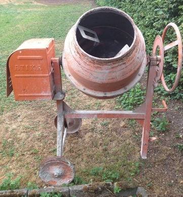

Friend of mine just strapped it to this with a load of gravel and let it roll for a couple hours with changing angles. Result according to him was very satisfying.
you have to choose the right size of Stones to not damage the tank. Let me know if you Need a bit more Details, I can ask.
