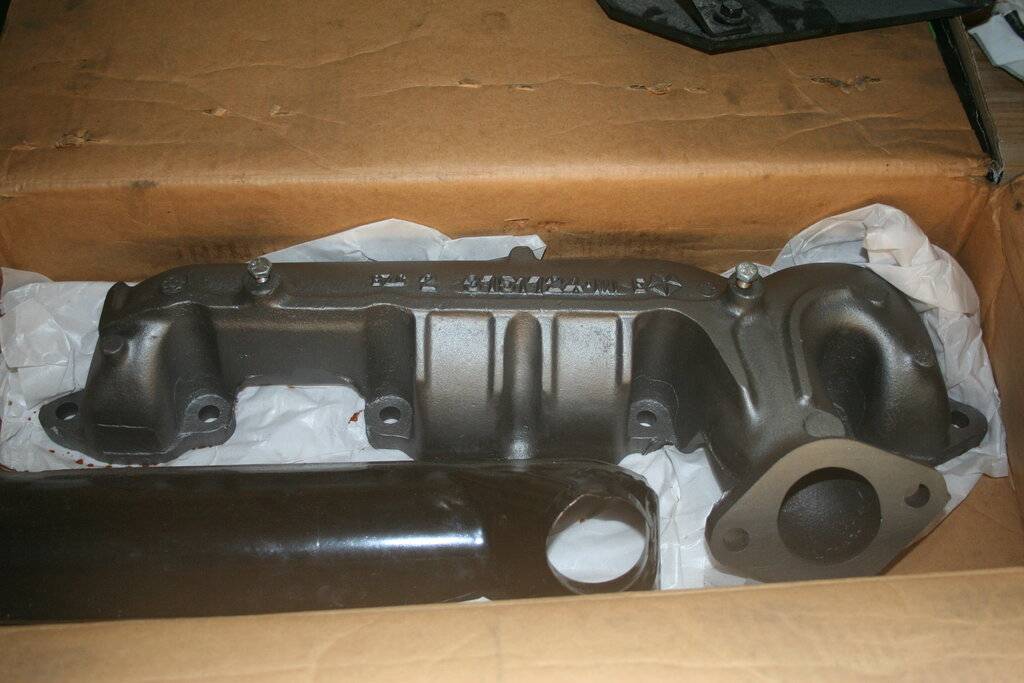

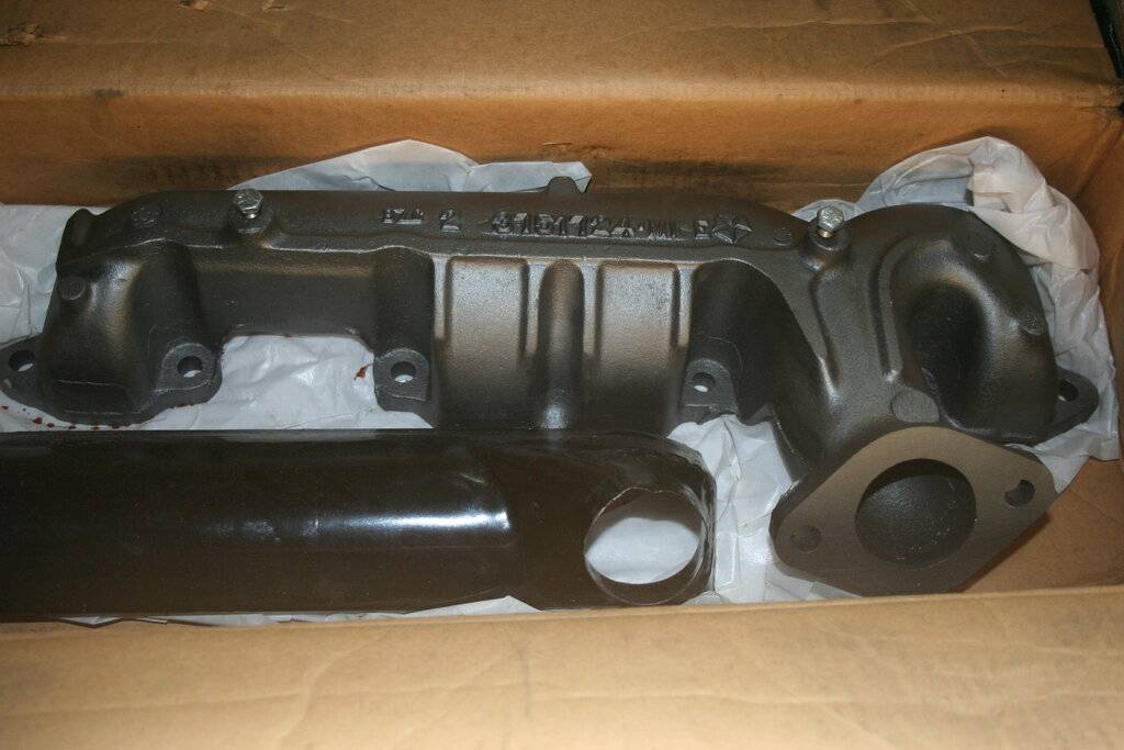

I private messaged you some pictures. I have 2 passenger side manifolds: one with a great working heat valve the other has no heat valve and threaded plugs installed. I only have one manifold for the drivers side . You can make a good set out of the 3 manifolds .

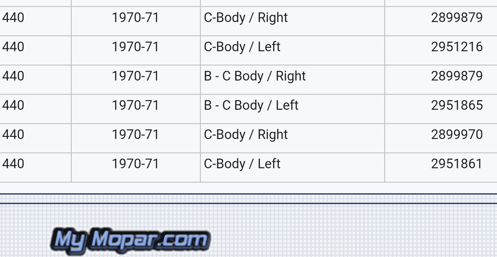

Do you have a parts book to verify that number? 861 and 865 (last three digits) were also available 70-71. Don't have a listing for 72.

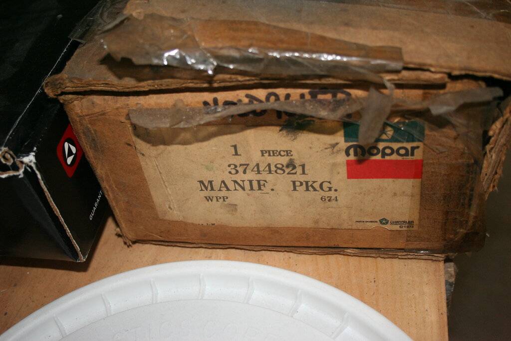

I don't believe there's a listing for a left side HP manifold in 72. The numbers from my White book are listed as part # 2951217 cast # 2951216 70-71 C body LH/HP 383 4. Part # 3418352 cast # 3418351 70-71 C body LH/HP 440. Part # 3744821 73 C body LH/HP. the photo's are the 73 manifold listed as HP but looks like a log style. Try to find a 70-71. Lets see some photo's of your Polara.

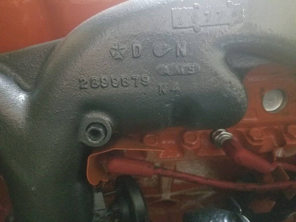

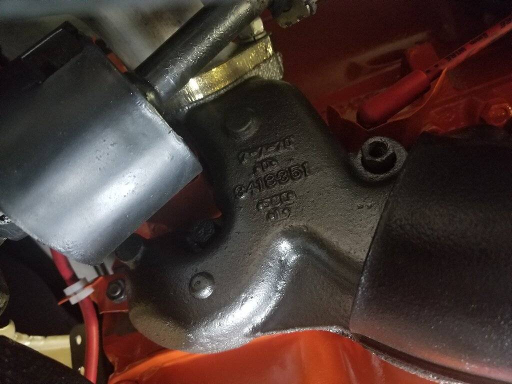

Pic's of the exhaust manifolds on my 71 U-code NYer:
Left side....
Right side:
