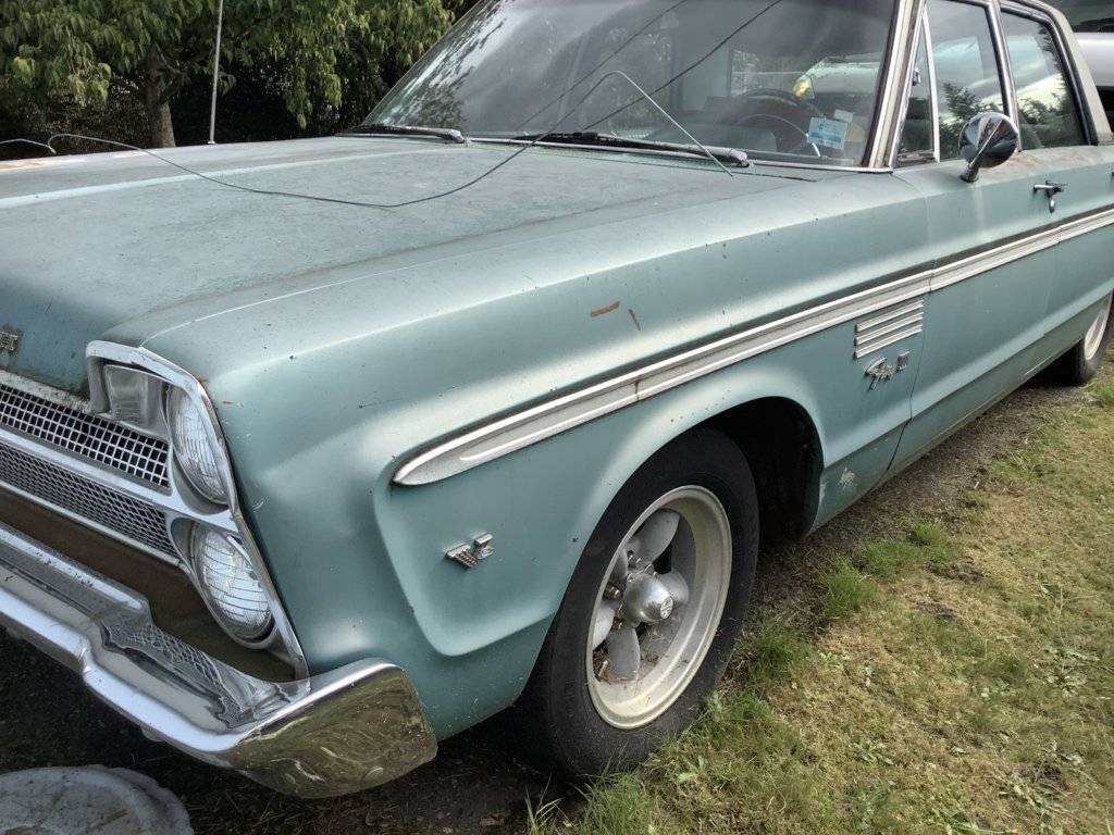

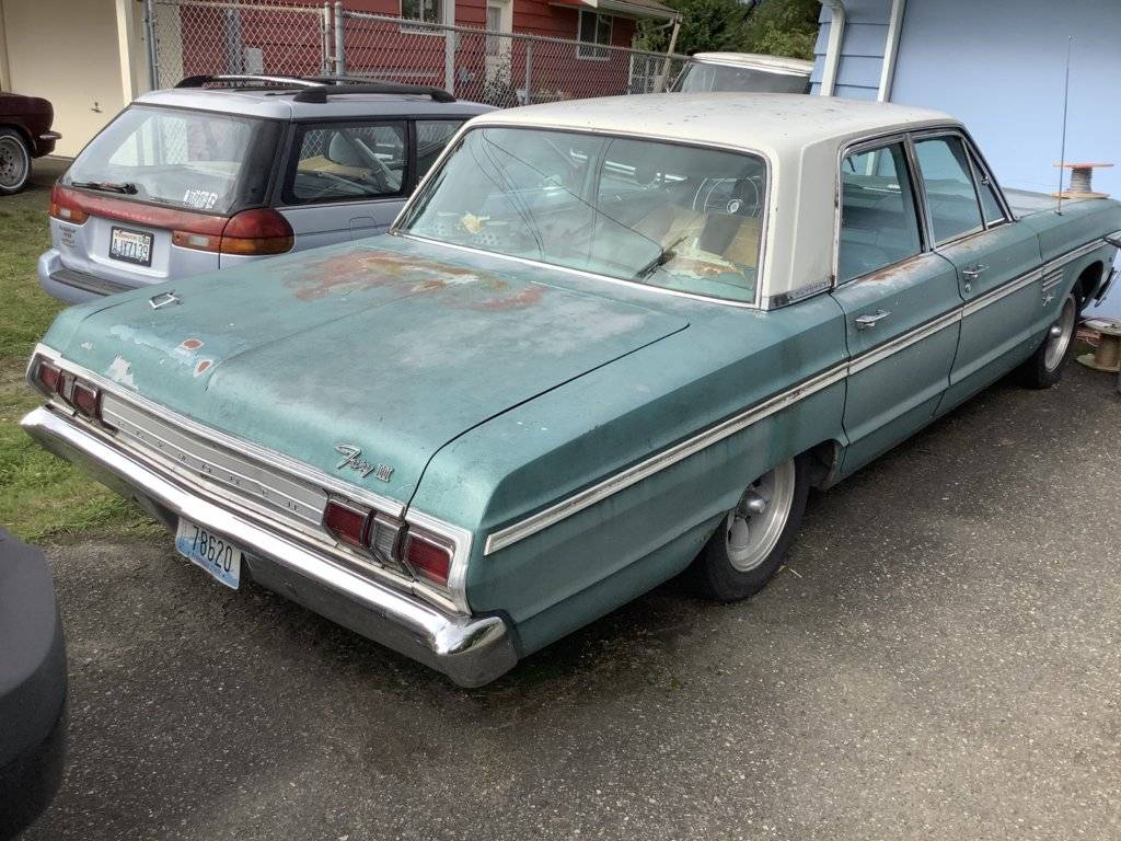

After thinking the last 25 years that my Grandpas 65 Fury III was gone after he gave it to my uncle, it came back to me through my mom. I plan to swap a 383 in but otherwise keep mostly stock.

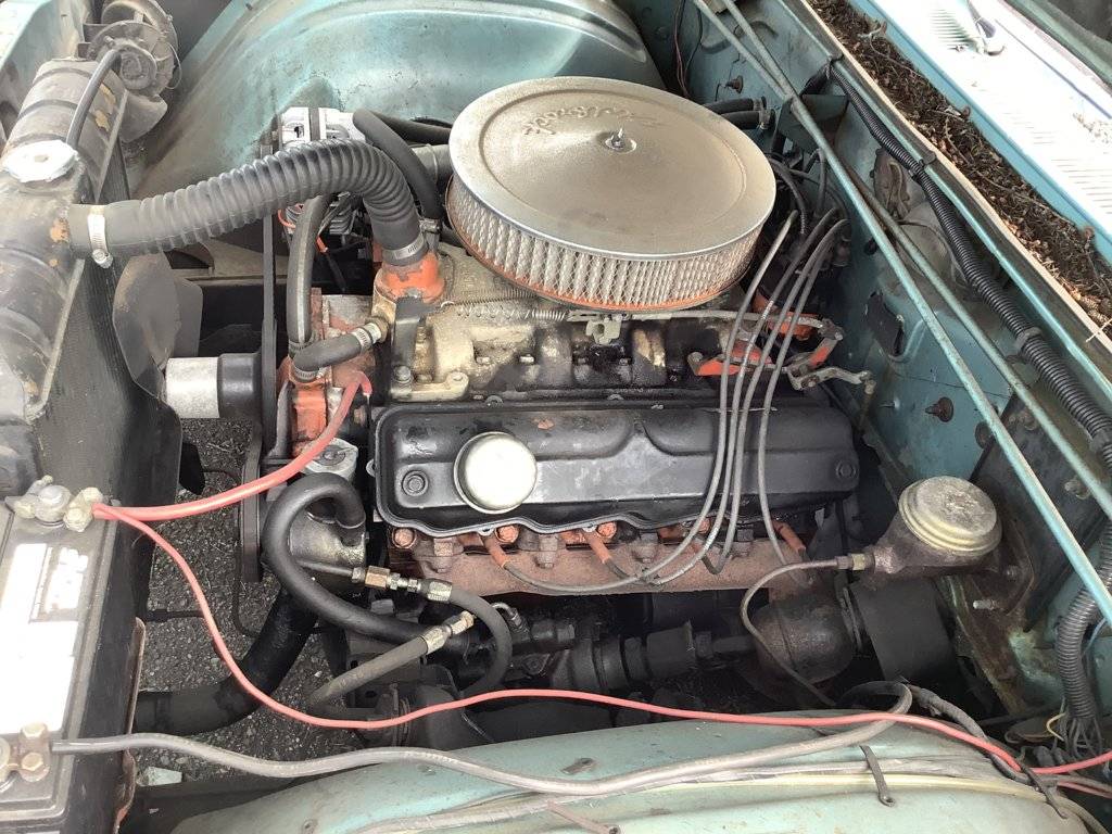

It runs and drives. I need to do the lower radiator hose, u joints, and the gas tank rubber tube-it leaks. My uncle put the Weiand intake and Edelbrock 4 barrel on it. As for the 383, it was the next engine up from the 318 in 65 and from what I can gather from the 65 parts book the motor mounts and tranny mount are the same. I may be wrong and would love to be pointed in the right direction if that’s the case

Yes, the 383 was the next-larger engine in those cars, from the factory. The mounts might be the same part number themselves (318 and 383), but is what the mounts bolt to the same part numbers? As in stub frame brackets and such?
Be sure to scope out how the engine wiring harness might be different on the Poly and the B engines, too. If you have the '65 Parts Book, check out the parking brake system, too.

Thanks for the guidance. I will double check the wiring harness, stub frame and the parking brake.
