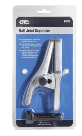

Boy, do I feel dumb,
I cannot see how to get the idler arm separated from the center link. I have everything else out. I cannot get my pickle fork between the center link and the idler arm. The local rental tie rod pullers have fingers that are too thick. I also cannot get enough room to do the two-hammer trick.
What stupid thing am I missing?

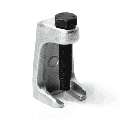

I recommend something like this.
I have had this puller for many years. Bought it from Auto Zone. Would recommend replacing the Through bolts w/ grade 8 Quality bolts, nuts, and thicker washers. Good for assisting w/ tie rod ends and center links or idler arms and pitman arms.

I don't see how you can use this to remove the center link from the pitman arm and idler arm:
That is more appropriate for a tie rod end. The center link extends to the left and right so the arms on that tool are going to get in the way.

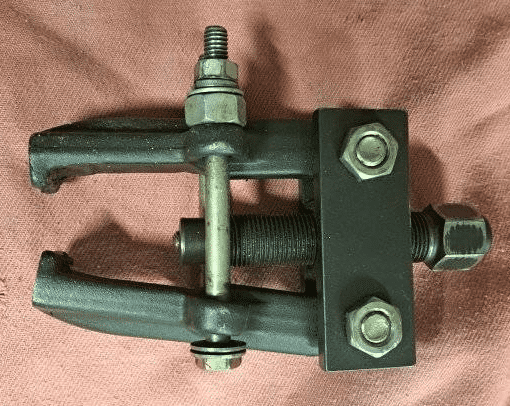

This tool (mentioned above):
Does have the correct geometry for the pitman and idler, I don't see many vendors selling it on amazon, one that does has 6 different sizes for sale, but these are advertised as bearing pullers. ?

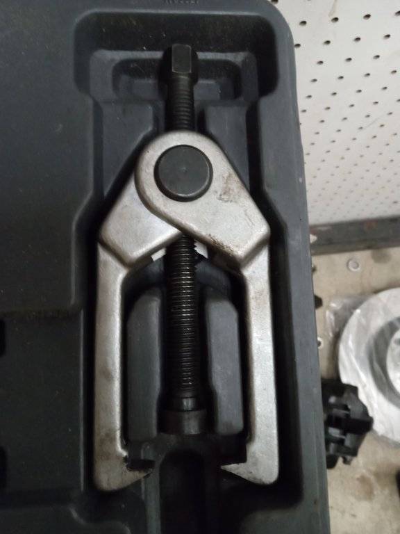

Amazon mostly sells these tools as kits, like this one:
I have something like the tool in the upper left corner, I bought it to pull the pitman arm off the steering gear of my '01 Ram (FWD) but it did not work - it was deforming (I was using a really long bar). I think the socket was also deforming. In the end I took an angle grinder to the arm, one-handed using my left arm on my back under the truck, and made a diagonal cut through the pitman without touching the steering gear shaft, and then the arm pulled off easily.
As I take apart a front sub frame I recently acquired, the arms of that tool in the upper left corner are too thick to get into position to remove the center link from the pitman arm, and the gap between the arms are too wide for the idler arm. A better candidate for the idler arm would be the center tool on the top row. The tool on the top right would be a better candidate to remove the center link from the pitman arm, but Amazon doesn't sell it by itself, only in kits. Ebay does sell it separately.
I'm not sure about the strength of the tool design of the tool in the center-lower row. I just don't see a tool of that design holding up without bending/breaking.
So that's where I am right now, looking for a tool to remove the center link from the idler arm and pitman arm. I could just remove the pitman arm and idler arm from the frame but I wanted to take all these components apart and separate them for storage / possible future use.
I feel even more stupid. I used the tool in the photo. Total removal time ..20 seconds. 39 years of wrenching and I never used one. Thanks everyone for the help.

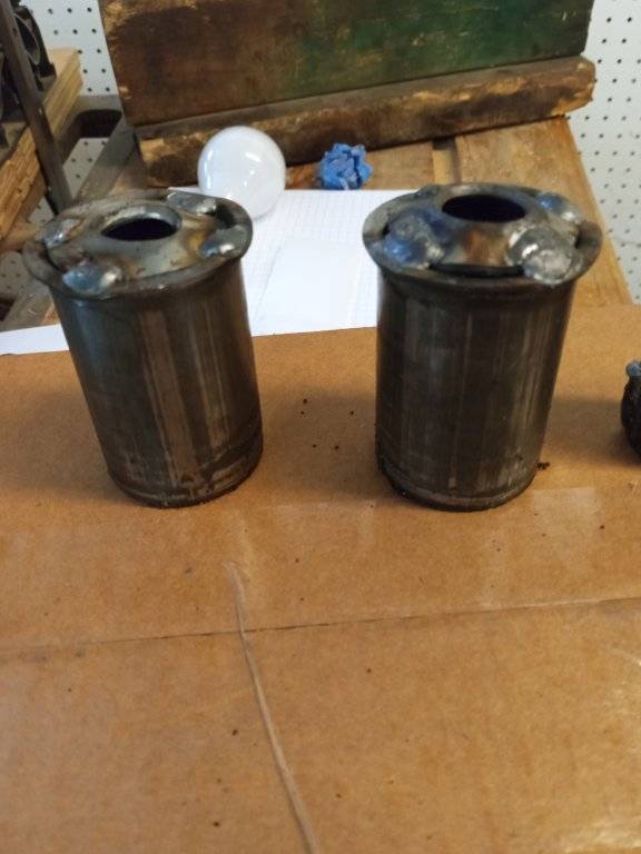

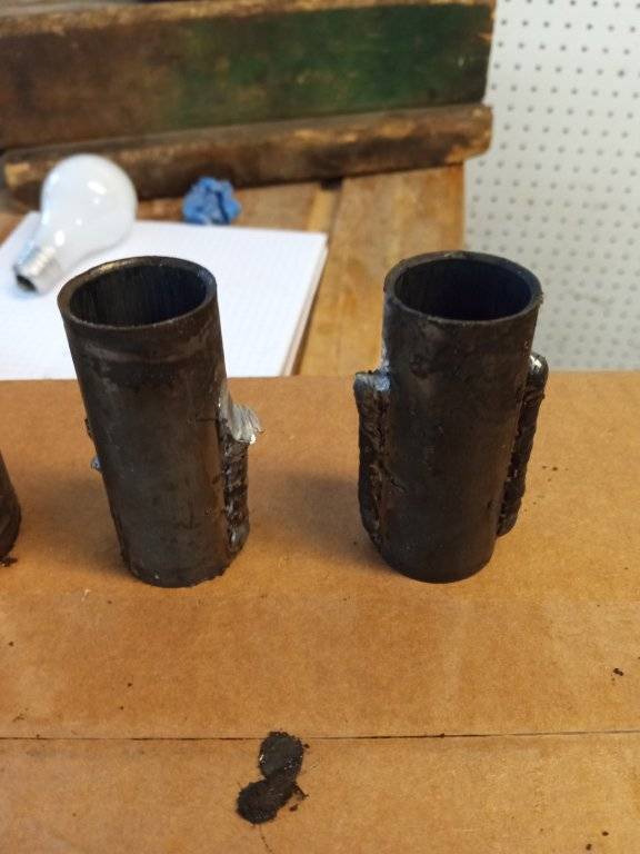

On a side note, my son and I got into a work groove last night. We got the upper ball joints into the control arm, and pressed on the new bushings. Also, we used the welding trick on the lower control arm bushing shells. Worked like a champ!
We also used the weld bead and air hammer trick on the inner shells on the pin. Also worked like a champ, and zero burrs on the pins.
I've never used that method, but I think the next time, that will be what I do... At least on the bearing outer shells.
I'm torn on that method for taking the inner shell off. I've had good luck grinding them thin in a couple spots and removing them that way... But I will give that some thought.

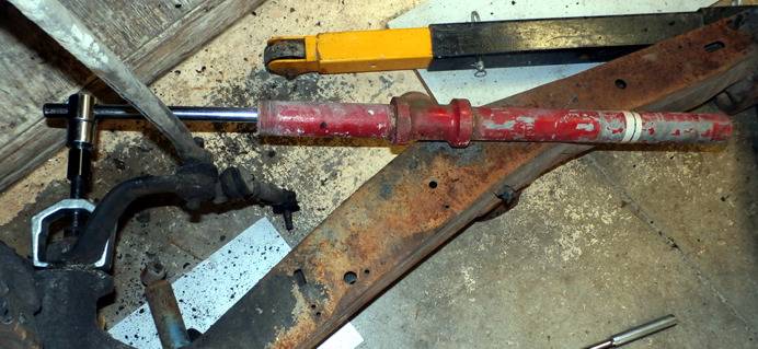

Any suggestions here?
I'm at the point where any more force is going to break the 1/2 to 3/4 socket adapter. A wedge or fork I don't think is the thing to use here unless you want to mess up the internals of the steering gear?
