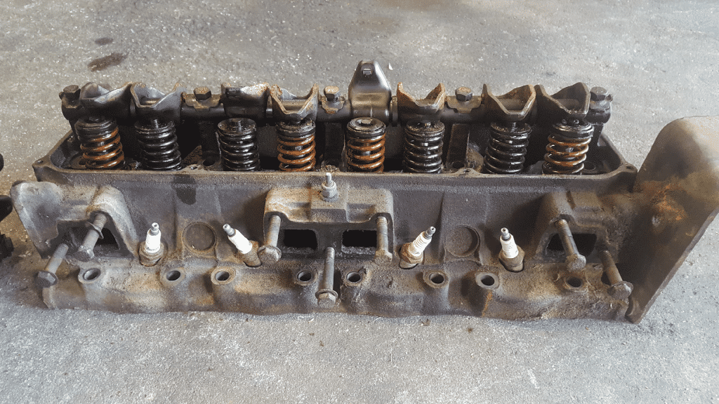

The industrial engine is a bit different. The heads have a coolant port in them and the exhaust ports are quite different. Dished pistons that are way down in the hole too.
Here's some pics I found that illustrate this.
Note the thicker rocker arms.
After my initial posting, I Googled the "Chrysler 413 Industrial" motor and came up with some interesting information and pictures in several forums.
The 413 Industrial motors were about durability, in some cases, a gear-driven reverse rotation camshaft. Smaller exhaust posts and slightly different bolt pattern. The angle plug heads came from an LA-style combustion chamber, rather than just a machining operation on normal B/RB chambers, plus smaller exhaust ports.
Other than the water pump/cyl head interface, the rear of the crank can be different than the aluminum case 727 rear crank flange and dimensions from the rear main seal.
Cams and valve sizes (1.88/1.50) were optimized for low rpm torque. With a 7-ish compression ratio.
Once again illustrating how what might initially look the same, is NOT the same.
End result can be that in order to adapt the 413-3 motor into your car, you will be pretty much rebuilding it in the process. I suspect the distributor would need to stay with the 413-3, too, for good measure. No need to knowingly rebuild TWO motors when you were trying to just get ONE rebuilt, to me. Too much activity and $$$ to get to the same end result!

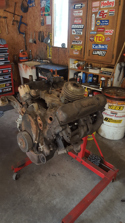

The 413 is a running candidate with a 727 attached, it wouldn't be going in to drive on the street, just so I can move it around the 40 acre property with less trouble. I was mostly just worried about the exhaust issues being as I can just leave the hood off if that doesn't clear... the motor mounts should be the same, unsure about the pan... if it's too bad I'll just throw the 440 together or maybe see if one of the 400s will run for now...

I don’t think it’ll work even just to yard drive it. The size of the heads and exhaust manifolds would likely preclude it from sitting down without steering box interference. I also doubt the oil pan is even in the same zip code as a car pan. The water pump housing and accessories likely stick out way too far and may interfere with the radiator. You say it has a 727 attached, so that likely means the crank flange is automotive, be it six or 8 bolt.
I think if you wanted to use it, you’d need to swap heads and oil pan at a minimum. Not out of the realm, but it’s extra work.
I have a reman’d 413 industrial long block in my garage and it has an 8 bolt industrial crank flange. My particular engine is likely just a block, connecting rod, and valve train donor should I desire to use it in a vehicle.

Thanks Travis, gave me a little laugh and some thoughts. I'll probably just end up towing the car out of the way for now unless I come up with something else to throw in it.
