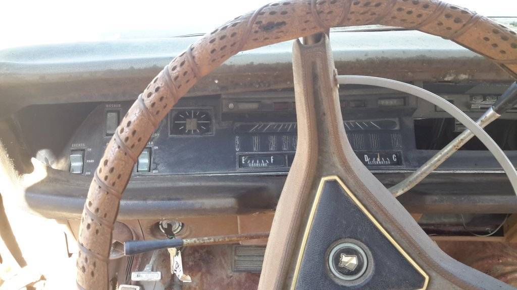

I ran across this picture of an '69 Fury II. Is this the ignition switch that I see to the left of the steering column. I've been around Mopars all of my years and i don't remember anything like this. My '68 has the ignition on the right side in the dash and I believe the '70 Challenger i used to have it was in the column.

Remember that well. On the left just below the Headlight switch.
1960 - 1968 are all the same dashboard mounted ignition switches and tumblers for ALL models -- "B" , "A", and "C" Body....
1969 was a 1 year only-- physically MUCH BIGGER Ignition Switch and Tumbler..... again for all model MOPARS....
1970, indeed, they went into the column....

I have a theory on the key being on the left on the 69 C-Bodies.
The 69 was an all new (for the most part) car, they knew the ignition switch was moving to the column in 1970 so they put it in a location that wouldn't be impacted. In the 69 dash there isn't anywhere to put a key on the right, so had they put the key on the right they would have had to mage greater changed to the designs both to put the key on the right and they to eliminate it. On the left, it was just the lower dash cover, on piece, done.

Alan, I believe you're right about the left side location being thought of as a safety feature, and also a way to keep anyone in the front seat from trying to play with it. As a leftie, I thought it was a great idea. But then the feds came along and buggered it all up.
The A100 pickups and vans had the ignition on the left, at least the '69s did. I can't tell you how many times I whacked my knuckles on the window crank attempting to put the key in the ignition!
