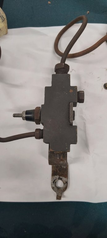

Maybe stupid question but, when changing from 4 piston Budd brakes to Kelsey-Hayes type one piston brakes, are the other parts still same? Budd System has tee part with brake warning switch ( looks like very similar with B body) and Kelsey-Hayes made metering valve, that's it no other parts. BTW, is this metering valve same as B and E body? Muscle car research LLC have repair kits for these, any experience about company/parts?

My memory says that Chrysler didn't do much to balance the brakes front to rear on C bodies until maybe part way through 1972. The smaller cars with disc brakes all had proportioning valves. I think most C's only had the warning light switch, which is your top photo, and possibly a "hold off valve", which they may have a different technical name for. I'll take a look at a couple of my manuals over the weekend and see if I can find an answer for you.

Thanks Jeff, and yes, -69 FSM didn't make a difference with these parts between Budd and K-H brakes. -69 they start with Budd but later that year they change to Kelsey-Hayes. So I'm gonna order repair kits...
I finally found my 1969 service manual. After looking at it, I'm pretty sure there was no difference in the hydraulic system between the Budd and K-H calipers.
What they call a metering valve is really a hold-off valve. All it does is keep the rear brakes from engaging before the fronts, since it takes more pressure to get disc brakes to grab than drums. Chrysler didn't add an actual front-to-rear proportioning valve until they went to the cast iron, all-in-one combination valve.
The rubber guts for the metering valve are probably the same between all the Mopar body lines. One potential problem is that some of the reproduction rubber parts they sell now are not compatible with silicone brake fluid, if that happens to be your fluid of choice.

Thanks again and good point that rubber parts question, I should ask that before ordering parts. But how about other rubber parts like front disk caliper and rear brake cylinders rubber parts, how can you know can you use silicone brake fluid?? One question leads to another...
