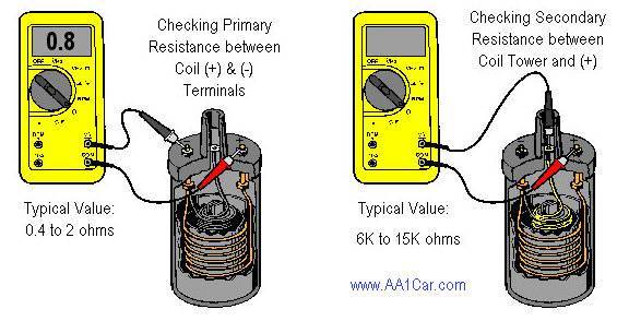

I bet it's the coil. Once in a while a new one will fail. Is it mounted on the intake? I had the same symptoms with my NYB.........it was the coil.
Yup it's on the intake. It would tick me off if it's the new coil...
Mine is on the intake too. It ran a little bit than the engine just quit. It was a brand new Mallory coil. I let it cool off and it would start and run a few minutes and quit again. I put the 37 year old coil back on and it is still running.
3
The good old Standard brand coil that they have churned a gazillion of over the years STILL has never failed on me.
