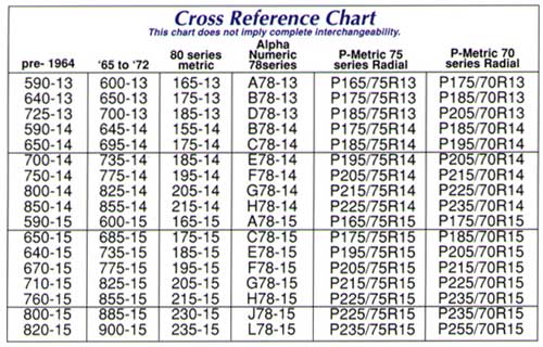

Vintage Tire Size Conversion Chart
Use the following chart to figure out the closest modern tire size to your car's original tires. Keep in mind these are close approximations and may not be exact replacements. Before purchasing any tires you should compare outside diameters and the tread footprint to get a better idea on how close a match they are. Your local tire dealer should have this information. Variations in tire diameter will have an effect on speedometer accuracy while the tread footprint will have an aesthetic affect on the appearance of the car. The best way to ensure a 100% correct look for your antique car is to buy reproduction vintage tires in the originally recommended size.
Pre-1964
1965-72
80 series metric
Alpha Numeric 78 series
P-Metric 75 series Radial
P-Metric 70 series Radial
5.90-13
600-13
165-13
A78-13
P165/75R13
P175/70R13
6.40-13
650-13
175-13
B78-13
P175/75R13
P185/70R13
7.25-13
700-13
185-13
D78-13
P185/75R13
P205/70R13
5.90-14
645-14
155-14
B78-14
P175/75R14
P185/70R14
6.50-14
695-14
175-14
C78-14
P185/75R14
P195/70R14
7.00-14
735-14
185-14
E78-14
P195/75R14
P205/70R14
7.50-14
775-14
195-14
F78-14
P205/75R14
P215/70R14
8.00-14
825-14
205-14
G78-14
P215/75R14
P225/70R14
8.50-14
855-14
215-14
H78-14
P225/75R14
P235/70R14
5.90-15
600-15
165-15
A78-15
P165/75R15
P175/70R15
6.50-15
685-15
175-15
C78-15
P175/75R15
P185/70R15
6.40-15
735-15
185-15
E78-15
P195/75R15
P205/70R15
6.70-15
775-15
195-15
F78-15
P205/75R15
P215/70R15
7.10-15
825-15
205-15
G78-15
P215/75R15
P225/70R15
7.60-15
855-15
215-15
H78-15
P225/75R15
P235/70R15
8.00-15
885-15
230-15
J78-15
P225/75R15
P235/70R15
8.20-15
900-15
235-15
L78-15
P235/75R15
P255/70R15

Problem is no one ever heard of or recorded the equivalent to L84-15's
Step 1. Google "L84-15"
This chart immediately pops up....
Step 2. Take equivalent size and calculate diameter...
Step 3. Unfortunately, that size is a truck size so you are not going to find a WW. This forces you to get as close as possible to a passenger car size as close as possible in a WW which would be 235/75R15. That size in a WW is easily available from at least 3 manufacturers that I can think of off the top of my head.
Step 4. Find diameter of a 235R75-15. Googling provides this chart...
28.9" or a 3.5% difference.
Step 5. Do the math...
So, when your speedometer is reading 60 mph, your actual speed is 62.1 mph.
Step 7. To correct this error, Google "Mopar speedometer gear chart...
attachment.php
Step 8. Select the correct gear for a 29" tire for your rear end ratio, buy one on ebay, and swap out your speedometer gears in your tranny. That takes 15 minutes.
Wow!!!...
