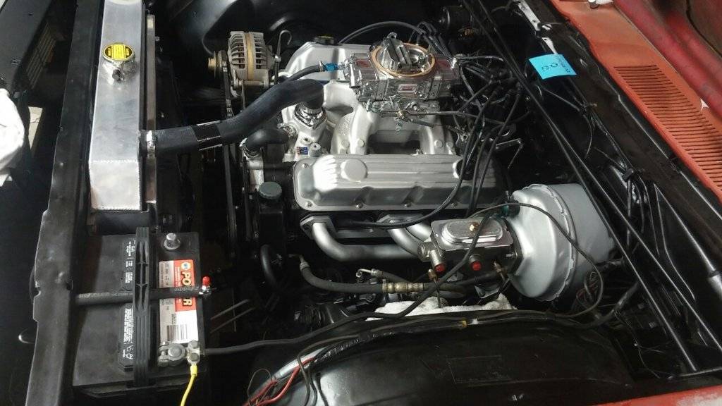

318 in 68 polara headers by Sanderson
Made for A body installation.
Perfect fit out of box..no mods no fabrication. Full size starter no interference from torsion bar. and yes you are all welcome...
Be sure to use ARP bolts and remflex copper gasket for flange and collectors. Also I coated mine with ceramic coating from eastwood products.
Before any one asks....
Yes those are magnum heads, but dimension wise the headers will still work.

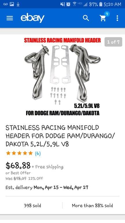

And yes, shorty Ram headers will work...however, do NOT buy the cheapy ebay or low buck steel headers. You'll be replacing them too quickly.
I run Gibson stainless headers on my Ram with Remflex gaskets. The quality is obvious.
