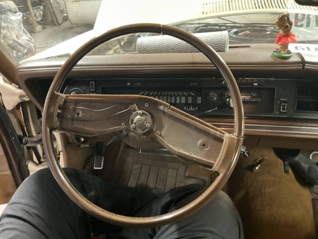

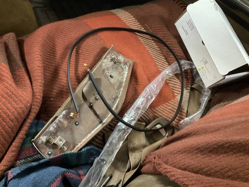

Hello all, as I am proceeding in making my T&C road legal, I am installing a new rim blow switch on the inside of my Tilt & Telescope wheel as the old one was missing.
It was not so obvious to me how this should be installed, I tried to check the chassis service manual, not finding much of help.
Could someone offer some guidance on this?
Picture of the switch and steering wheel attached, the two wire you see in the wheel are just laying loose.

It should just be a matter of figuring out the fitment of the connections on the end of the switch in relation to the steering wheel. It looks like they're perpendicular to the strip? Once that's determined, by the looks of it you only have two options, connect the wires, and honk away! Assuming your relay is good. I'd check the switch with a multimeter too, just to know.

As to replacing the switch, the first thing to do is to remove the old switch from the groove it fits into in the steering wheel. I suspect this would be problematic, all things considered. Once that is done, then (as the service manager said), you make up some soapy water to lube the items with and then start to feed the new switch into the groove, working slowly until it is all the way installed. Then install the wiring and that should do it . . . in a perfect world.
Not sure if some silicone spray lube might be a better choice than soapy water? Do NOT want to damage the switch during installation, obviously!

Below is an on-line post regarding installation of the circumferential rubber covered part of the switch that should help guide installation of the switch into the wheel itself. There are two wires, one at each end of that switch - one that uses a phillips short screw to install the ground lead near the center of the wheel and the other lead is the positive end that has its own connector to a tab near the center of the wheel and are
both part of a white plastic tab as shown below. I took the steering cover off the center of one of my rim blow wheels to show you just how those switch wire ends connect to the wheel and it should be self-explanatory as shown below.
Here is the switch installation post regarding the switch mounting on the inside of the steering wheel as the first step: https://img1.wsimg.com/blobby/go/c30e9cd2-2c0d-4f03-8af3-aa0349b41b92/RIMBLOW SWITCH INSTALLATION PROCEDURE.pdf
One just needs to be slow and careful regarding the rubber portion of the installation but it can be done since I have done a couple myself.
