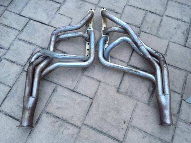

I'm also selling a set of Hooker Super Competition headers if anyone is interested
Oh I didn't notice all the other responses. Thank you everyone for the help! I should have the new studs in a week or so so hopefully this will work! Here is a photo of the headers. They have surface rust even tho they were coated (I hear that's why they started rusting) they can be cleaned image1.jpg
