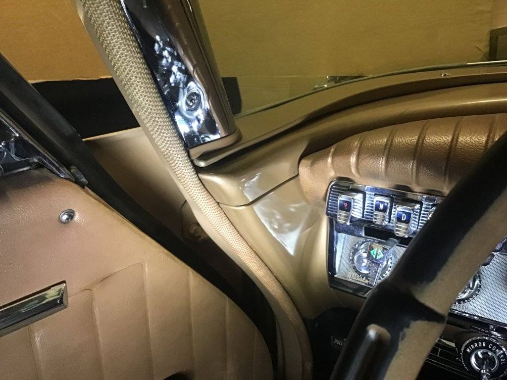

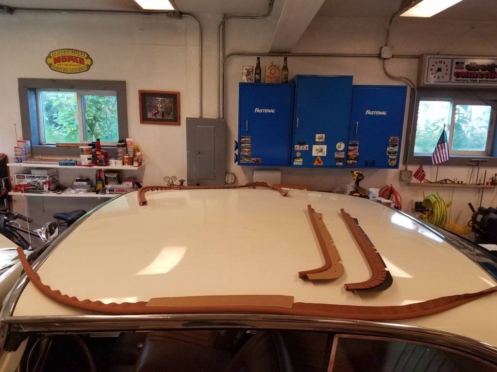

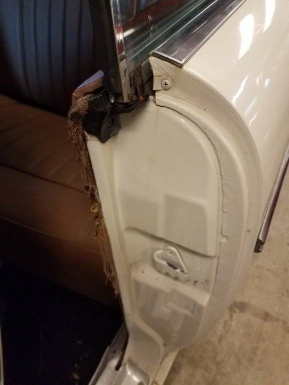

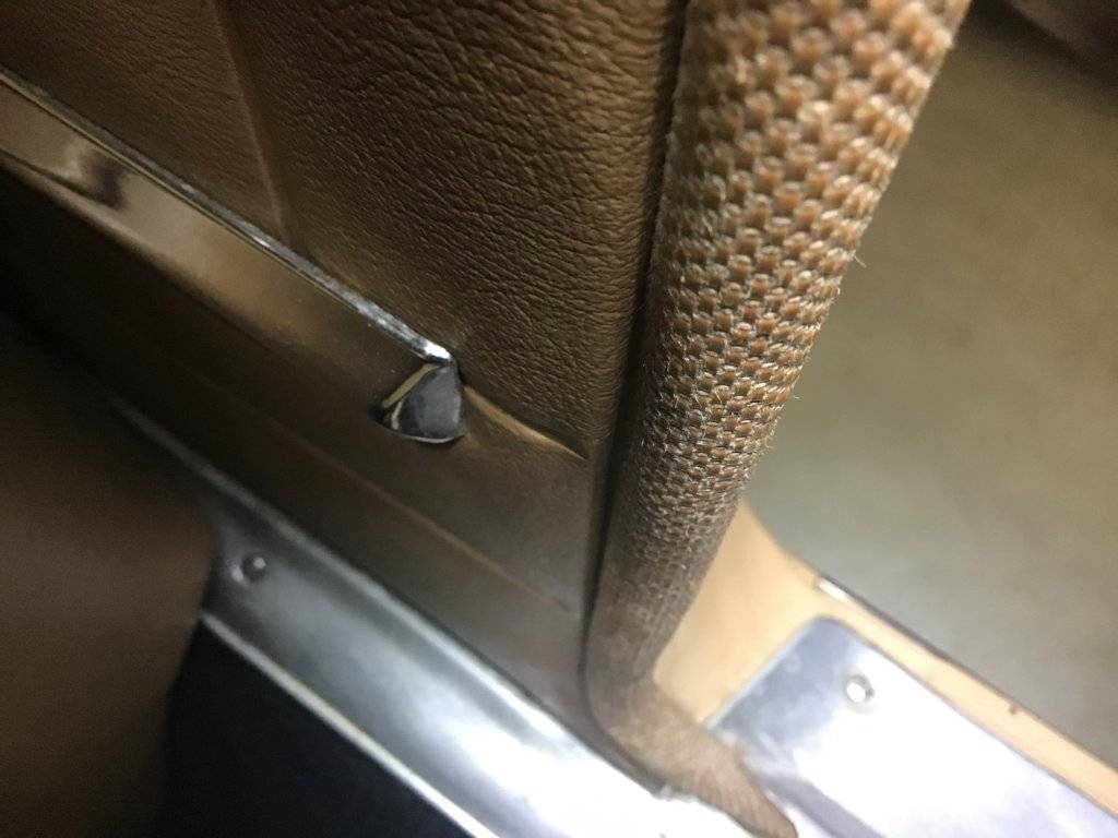

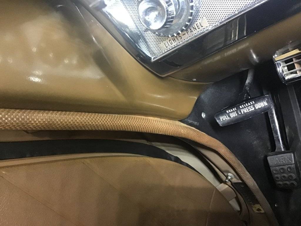

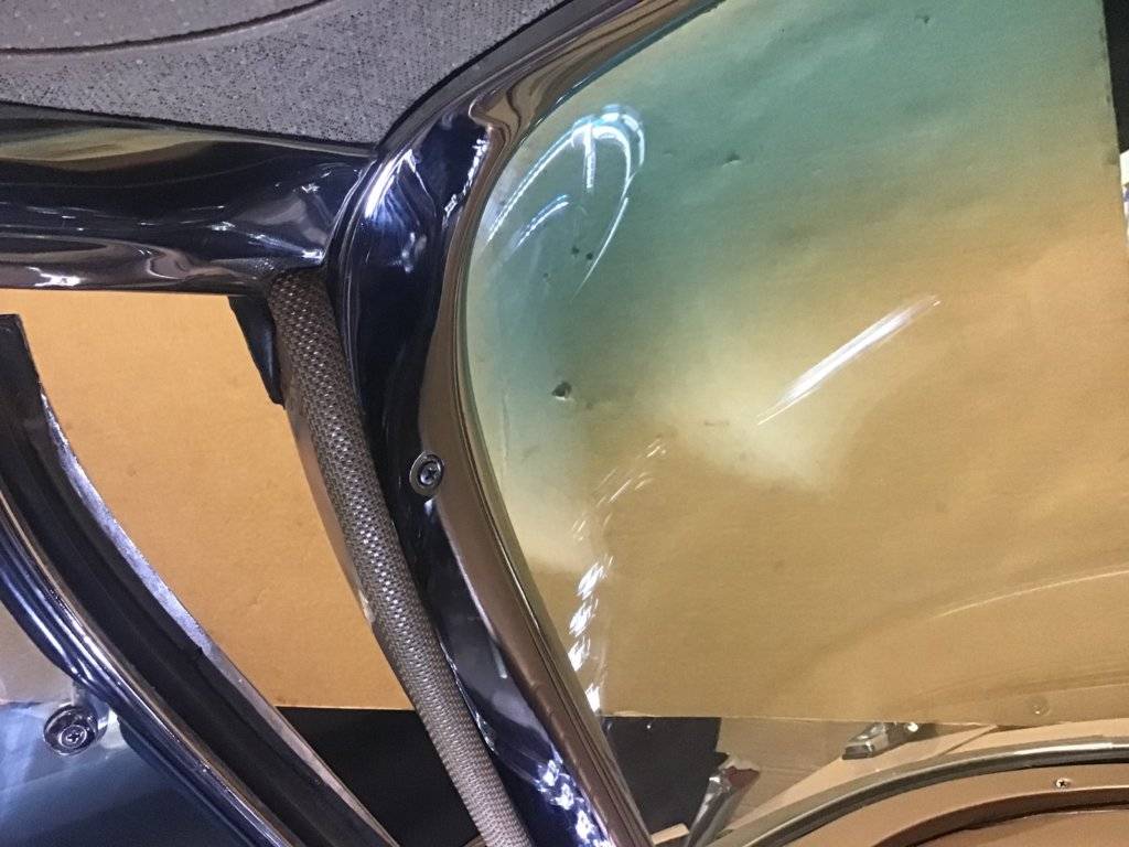

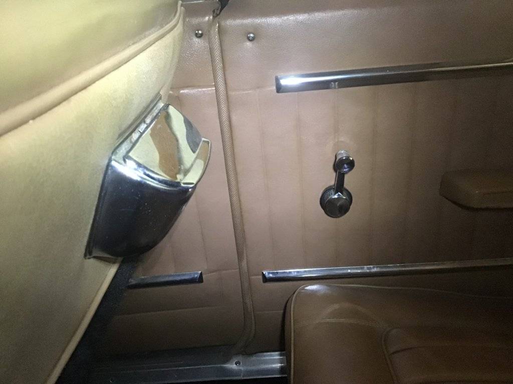

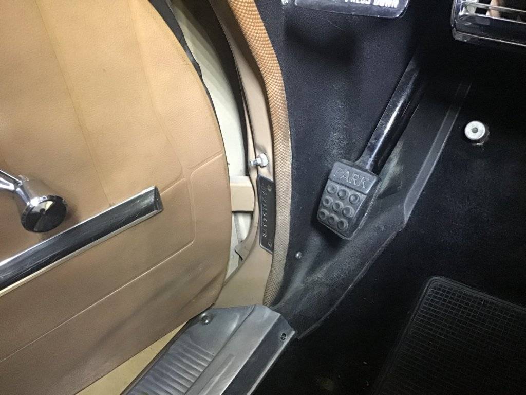

Thanks!! A picture or two would be great! I appreciate it!!
It goes underneath everything so you’ll have to remove many pieces.
Last 2 are the rear
