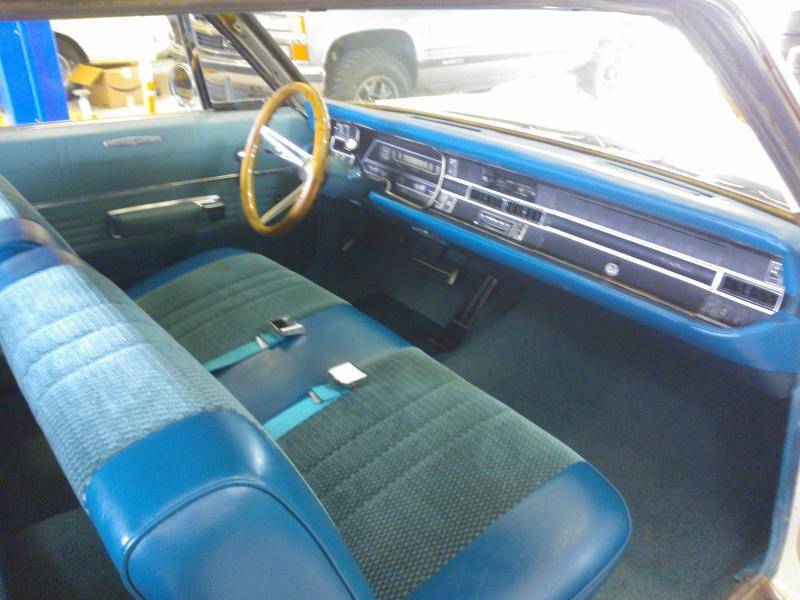

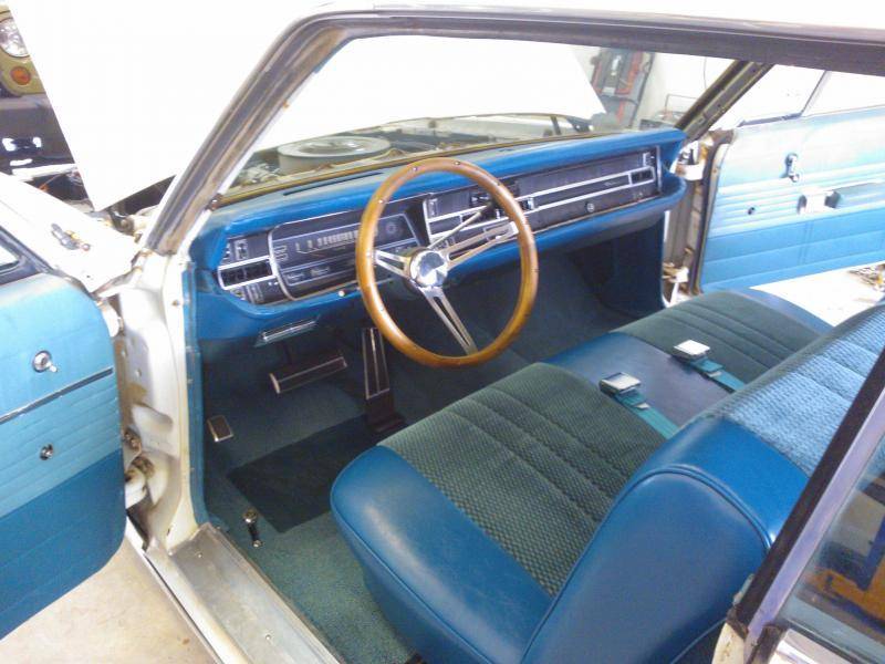

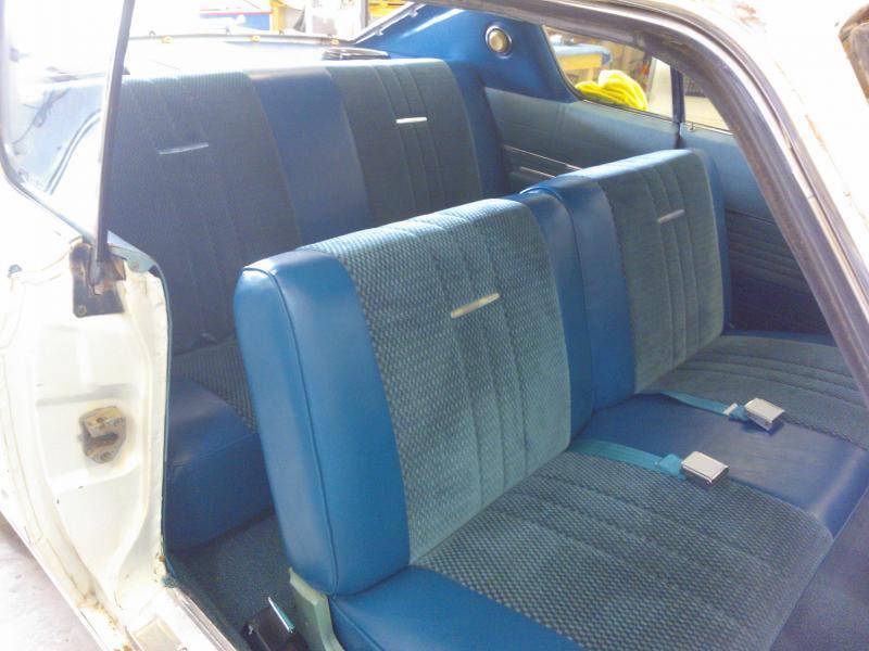

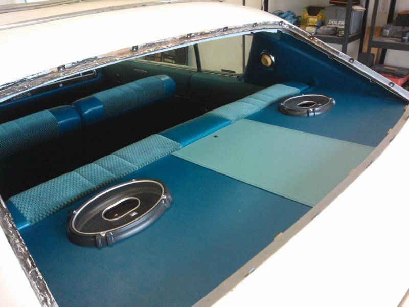

I'm in the final stages of putting the interior back together, thought I would share some pics with ya'll. For some reason the color of the vinyl on the seats, dash, and sail panels looks very blue in the pics, it is actually more of a darker bluish turquoise. The headliner and carpet are turquoise also.
View attachment 37257View attachment 37258View attachment 37259View attachment 37260View attachment 37256
Them little guys can sure make good cameras, but they're all absolutely lousy with any kind of turquoise, so don't apologize for your pictures.

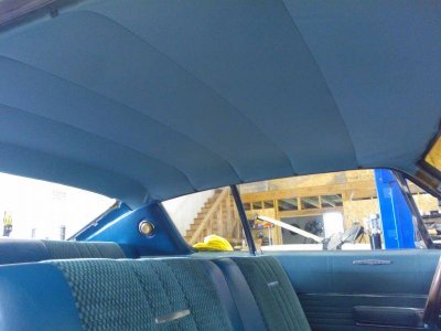

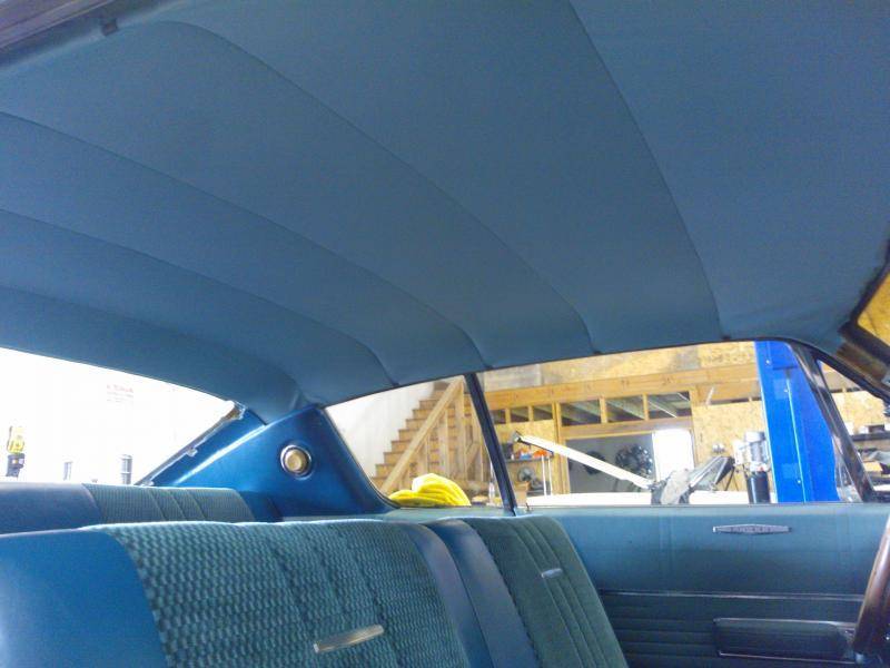

How hard was the headliner? I suppose I'm going to have to do mine at some point in the next couple years. Oh and great job BTW.
How hard was the headliner? I suppose I'm going to have to do mine at some point in the next couple years. Oh and great job BTW.[/QUOTE
How hard is the headliner you ask... well that depends on your patience level lol. This is the first one I have done so I took A LOT of time fitting and stretching the headliner before I started cutting it to size (yes they come a little larger than finished size). Do some youtube video watching on the subject just so you know what to expect. Mine didn't turn out to be true resto quality, but I am happy with it... I guess. I ordered mine from Stock Interiors, good quality and looks good. Instructions are NOT included with the headliner. Also number or do something identify your headliner bows, they are different sizes.
Best advice number bows front to back or what ever kind of system you want to use, guaranteed two are almost identical and will drive you crazy, oh and gloves are a good idea as those toothy attachment points are sharp, plus light colored ones can get smudged as you are pulling and tugging.
