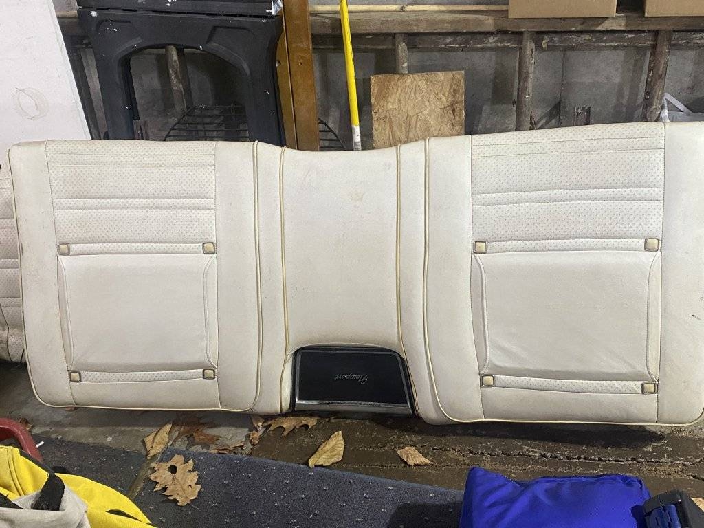

Seat popped right out. Pretty easy once you know tge right way to do it.
Thank you for your direction help

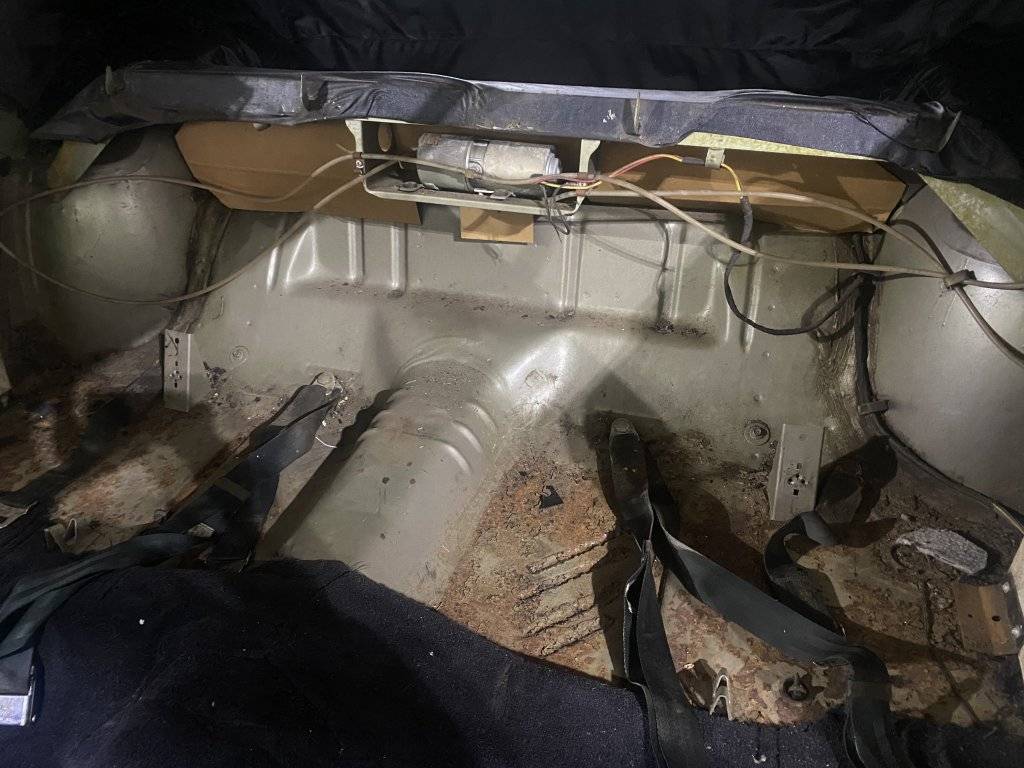

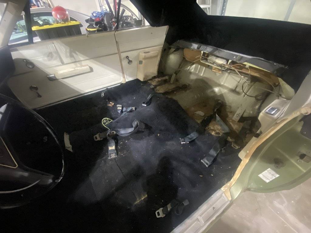

The car was always garaged or in my barn. So very little rust but the interior did dry out and crack
Seat frames are all good. Actually found the spec sheet printout for the original car build from Chrysler. Pretty cool find
