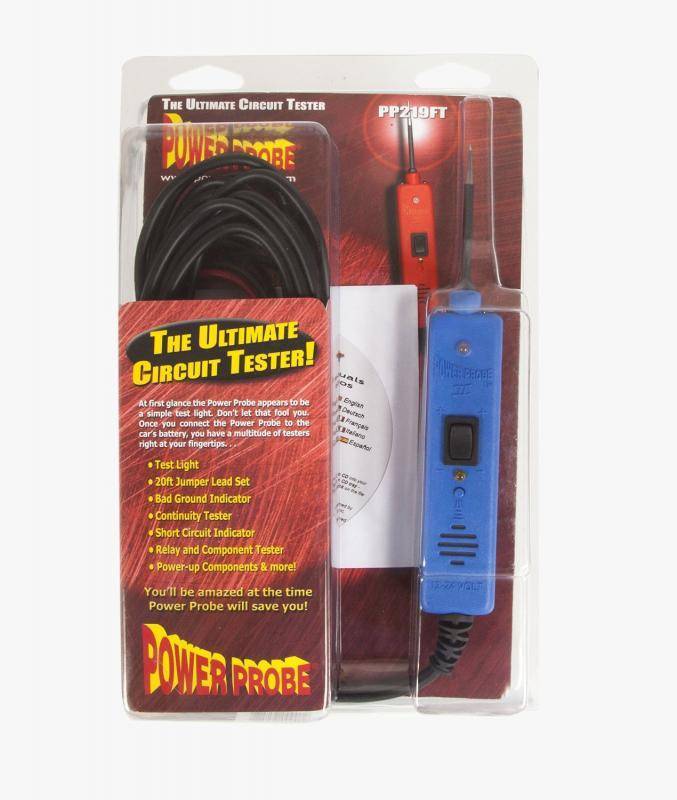

There are lots of versions of this tool,but the basic one is hard to beat. It acts as a test light which show pos and ground .It also can apply a ground or voltage and more, it saves a lot of time in trouble shooting.
