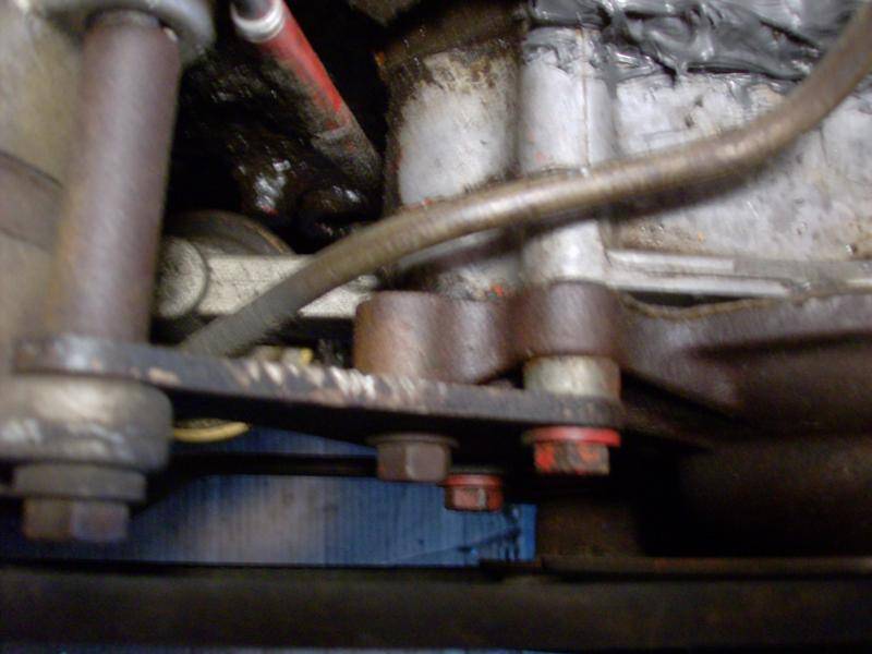

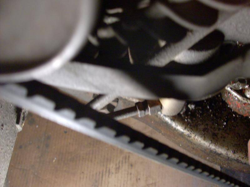

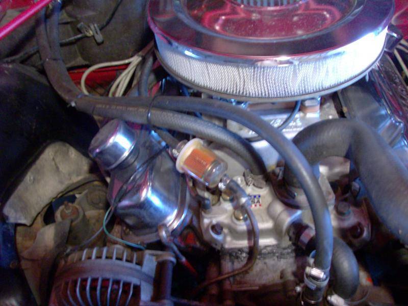

My fuel line in the front where it curves is about 3/8" from the block. I can lift it up a little more,getting about 3/4" of distance. I have also installed a 1/2" spacer. This wasn't an issue until today when I was running errands and it was 85 degrees. Water temp was normal. After I would park,fuel filter was empty. Took much cranking to fill it and restart. I'm thinking new fuel pump,which I have, and raise fuel line to get that 3/4" distance. The rest of the line looks like its where its supposed to be. 318 w/600 cfm Eldy.

Two things, an insulator/shield under the carburator and blockoff the heat riser on the manifold.

I'd be more concerned if the line was that close to the exhaust manifold, but if you believe that this is the problem area, you could try bending the line upward slightly by hand. It shouldn't break the line if you are only trying to get another 1/2" to 3/4" clearance.
Only downside I can see is that you may have to remove the alternator to get room to work. :(

Replaced fuel pump,inspected all of fuel lines. No issues except where I mentioned in the front. I did get it to raise a little bit by using a zip tie. It raised the fuel filter a bit too. Will test drive later tonite when it cools off slightly,its 90 degrees out at least.

Test drive went well, the heat sink issue is still there but at lest the filter was not empty. Had to crank a little bit to restart but not nearly as much as before.
