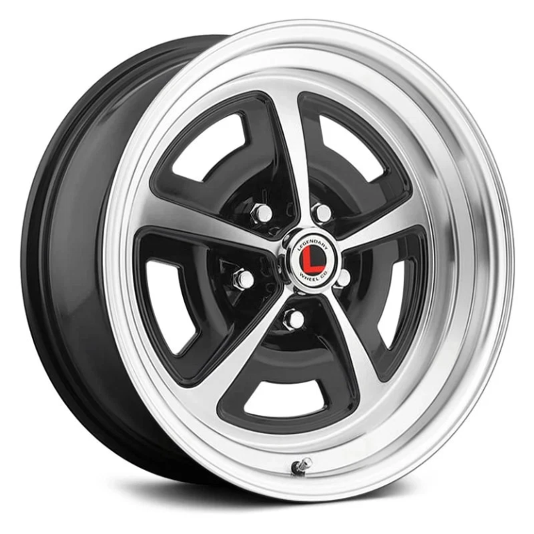

Legendary Wheels make a Magnum 500 in 16x8, is that what you're after? Pardon Our Interruption...
I don't want a rim that wide, because I don't want wide tires. 225 is what I'd aim for. And the 8" rims have back-spacing too high (like 4.5 inches).

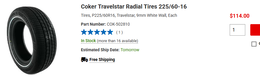

I see lots of choices in 16" tires (225-65R-16 and 225-70R-16) with prices starting in the $100 - $125 area. Including Hankook Kinergy. But yes, no white-walls in any 16" tires do I see.
