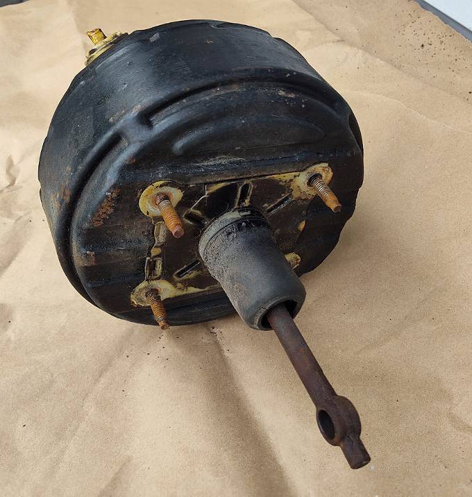

I need to rebuild the brake booster on my 1963 (non-letter) Chrysler 300.

The listing states that this is correct for "all 1963-4 models with Bendix power brakes."
Is it correct to assume that "all models" had Bendix power brakes?
Is this kit correct for my '63 300?
It LOOKS okay, but I'd appreciate your input on this before I order it.

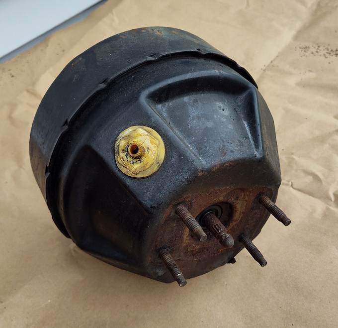

I’ve seen 2 types of boosters offered 63 Chryslers.
I would check with booster dewey
That's exactly the problem with this 1963 year. It's a "shoulder year: and it's a puzzle to find what part is correct. It's frustrating.
It's almost as bad as my wife's 1974 Spitfire. Triumph was in in tough financial shape at the time, and they just threw whatever parts they had laying around to build their '74s. Some '73 parts, some '74s, some whatever was on the shelf.. Her car had a cordovan interior which I never found was an option for a 1974 Spit. When I refurbished it, I had to go with a black interior.
I'm hoping I can get correct parts for my '63 Chrysler on the first try.

https://www.parts123.com/parts123/yb.dll?parta~partsort
Thanks for the steer to Harmon Classic Brakes.
They have been extremely helpful.
My booster is off for a rebuild.

Google Harmon Brakes https://www.parts123.com/parts123/yb.dll?parta~partsort
