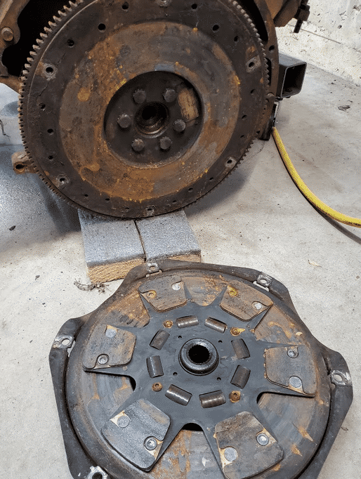

oops, a pic of the clutch and flywheel got attached to the thread too. I was going to post a thread asking if they still looked usable but changed my mind because I don't think it'd make sense putting it all back together with a clutch of questionable condition. But since it's here, feel free to comment on it. Maybe it's totally fine...
G'Day,
Advice of an Old Man, If the Clutch looks At All Suspect replace it & do the Job properly.
Unless you enjoy Busting Knuckles & Sweating your Butt off under a Car do the Job while it's All out on the Floor.
So much Simpler & Easier, Nothing Worse or more Annoying than having to do the same job Twice.
Yeah that's what I figured too
