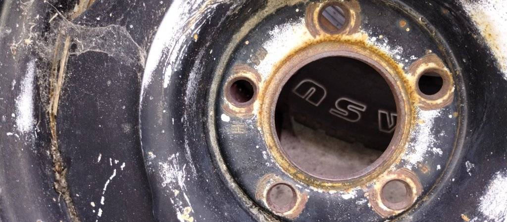

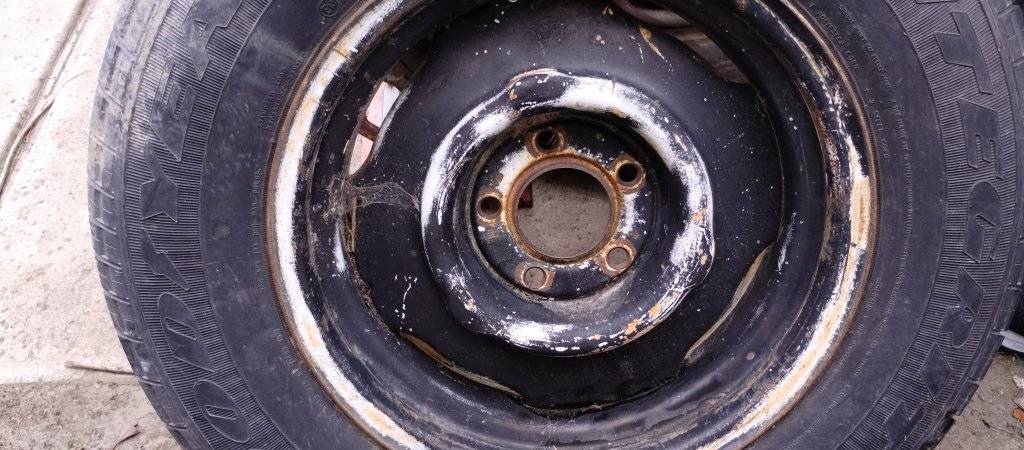

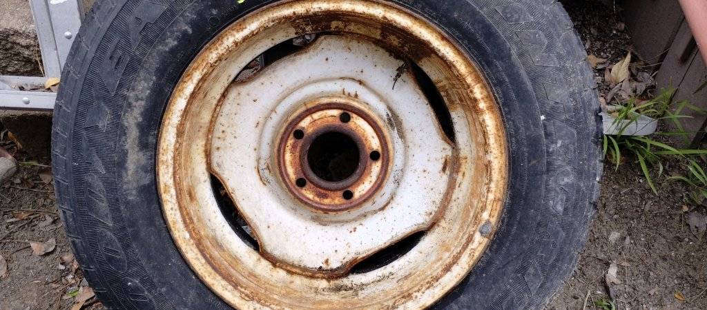

Trying to identify which out of my pile of tires was the spare for my 68 Newport. Help please and thank you :)
It's the center section that looks like a 1972-era 15" wheel to me. All drum brake C-bodies were 14" prior to the Fuselage models. 15" wheels were only on disc brake C-body cars from '66-'68, when the 15" wheels were needed to clear the 4-piston disc brake calipers.
CBODY67
The spare should match the other wheels.
That style wheel was used on the 69 Polara, it is a heavy duty wheel.
