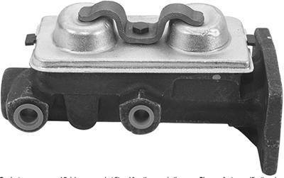

Bolt on cap for all drums,
Wire held cap for front disk/ rear drums
Careful, there are drum/drum masters that have the bail.
Same size reservoirs drum/drum.
Different size disc/drum.
This is a drum/drum, it was later replaced with the correct looking one.
Not the best picture but this is the drum/drum
