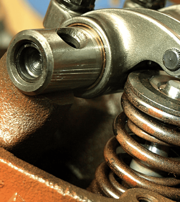

My first thought was rocker arm interference on the top of the valve spring, keeping the valve open. Similar to the pic below.
You can put #6 at TDC on the compression stroke, then bolt down the rocker shaft while watching #6 valves. If one of the valves is being forced open due to the valvetrain I would think you ought to be able to see it as it happens.
