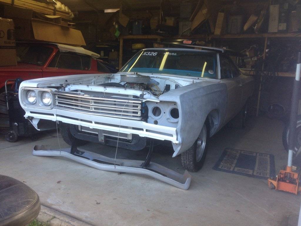

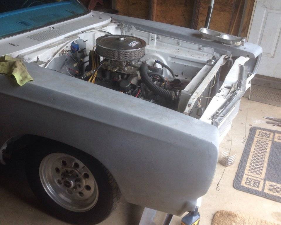

finally got time to work on my stuff. Fought a tire rub all season last year so decide to pull the 2 inch lowering blocks back out which raised the back up away from the tires. I also finally got one of my glass fenders bolted on. Fit was awefull. Spent several hours shimming & oblonging holes. Got it looking pretty good. Now for the other side. Maybe next weekend can can Bob day too

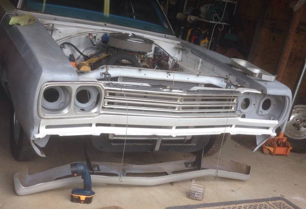

I got the other fender mounted. Installing the lights & headlamp bezels requiring more creativity just to mock them up.

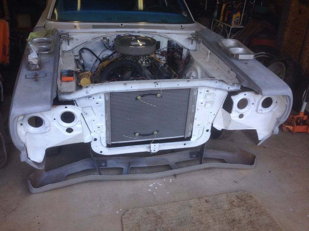

:lol:Decided I had better do some of the paint work while I had time & had some nice weather. I've got a plan for the driver side headlight bezel. It involves cutting....
This would be a good time to install that 16 inch electric fan I bought a year ago. It's got a 12 inch on it now. Struggles on a hot day to keep the teener cool. And eats up my battery. Just might do that too. Put a toggle switch on it to cut it off when I don't need it
