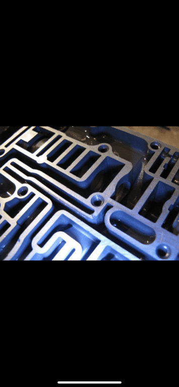

I used it to fix my transmission valve body. There was a galley that had split under the cover. I JB’d it and used flat plate glass and sand paper to machine it flat.
At the time (2008) I was second guessing my fix so I ordered a new valve body off E-bay. The guy contacted me and asked why I thought I needed a new one. I explained the break and how I fixed it. He assured me that the JB weld would be just fine. He explained to me that the field fix was to drive a 3/8” lock washer in there to support the wall. As you drive it in it fits the galley perfectly. It seems that after ‘68 Chrysler added a support dam in the casting to prevent this from cracking. He said he would still sell it to me if I wanted it, but thought that my fix would last forever. So still running my original valve body with JB Weld.

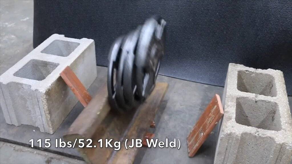

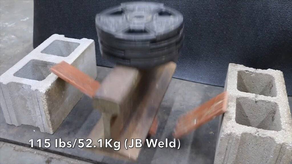

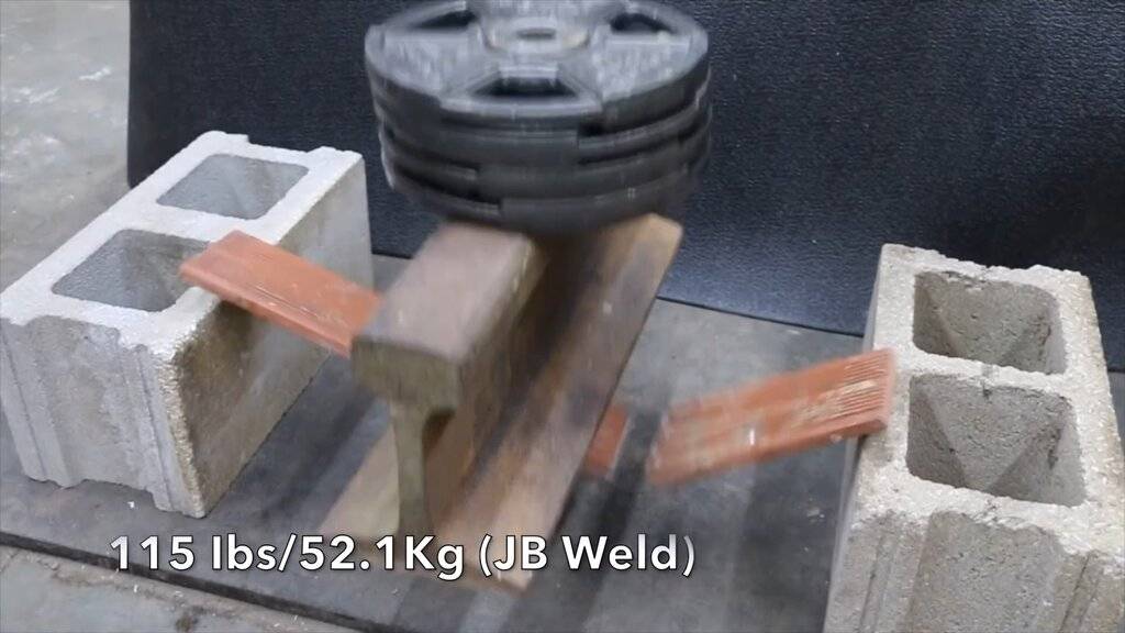

I'll call it out as the bullshit starts at 5 1/2 minutes.
JB Weld did break at the joint.
Is Flex Glue better than JB Weld, Gorilla & Loctite_  Let's find out!_00_05_24_01.jpg
Is Flex Glue better than JB Weld, Gorilla & Loctite_  Let's find out!_00_05_24_02.jpg
Is Flex Glue better than JB Weld, Gorilla & Loctite_  Let's find out!_00_05_24_03.jpg
Is Flex Glue better than JB Weld, Gorilla & Loctite_  Let's find out!_00_05_25_04.jpg
And with the wood joints anyone that has taken a good Jr High wood shop class knows you have to clamp any wood glued joint.

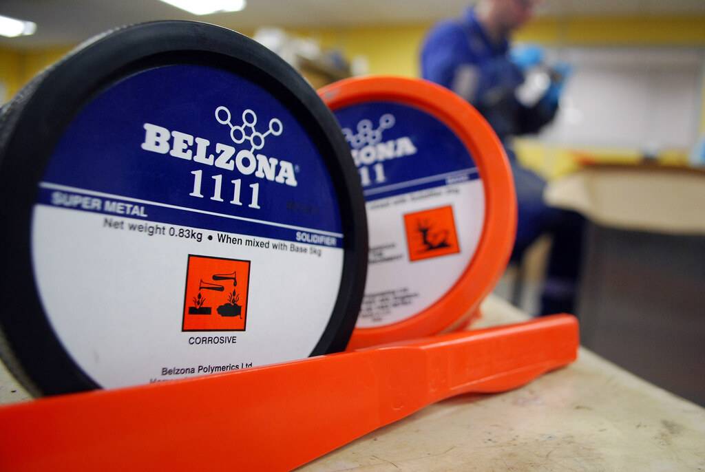

I'll throw another monkey into the 'mix'.
Very popular in the Offshore Industry. (remember the keywords 'Emergency Fix")
