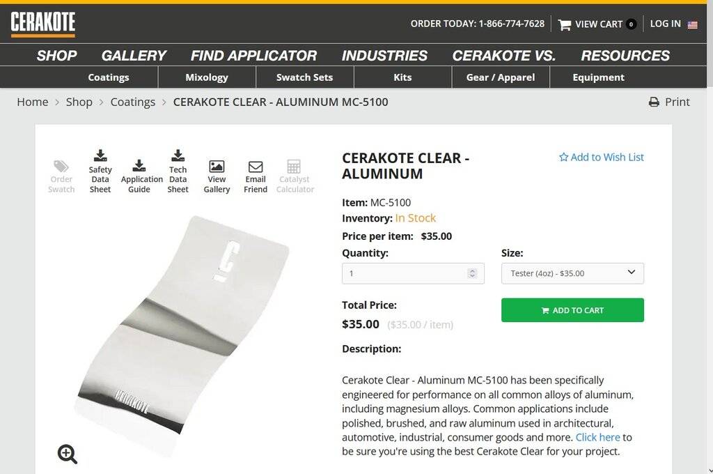

You might want to check into this product. I've never tried it, but it looks promising.
Cerakote - CERAKOTE CLEAR - ALUMINUM
