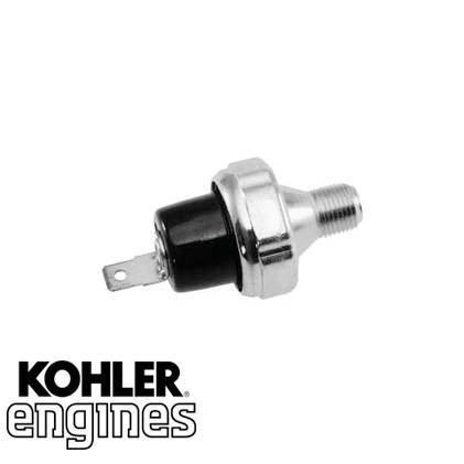

Just a thought,Not knowing how old it is, but they had (later models) a low oil switch. I had two go bad on two different units that kills the spark. We replaced one,pulling the engine and removing the lower case. the other we just by-passed. Again just a thought.
Interesting thought on the low oil switch I know mine has one, and i checked the oil to find it low so i topped that up but the motor still wont start.where is the low oil switch located? Also is it manually reset and if so, how?

I'd second the low oil switch. It's the easiest single point of failure to test.
I just found where this switch is and it looks just like a mopar switch you find in many cars,
Location, not sure on a 26 hp. On our WheelHorse mower it was in the block. I think it was 18 hp.
