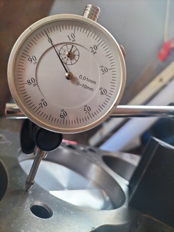

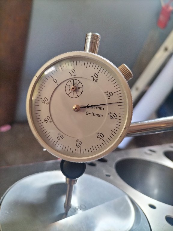

Please assist me in finding a solution to my issue. So I'm rebuilding a 1967 la 318 engine with kb167 pistons, now the issue that's developed due to the machine shop decking the block before I actually gave them the pistons in order toas determine the amount they can deck it too.
Long story short is now on assembly the left/passenger side of the block the pistons are protruding by 0.013 while the right side is flush.
Now the issue is this engine is an early 67 so it has the "66" 273 closed chamber heads so I can't skim the one head slightly less to correct compression.
I do believe one can use different thickness head gaskets to compensate, problem is I'm in South Africa so getting two different thickness head gaskets from a supplier can be an issue as I haven't got any contacts that can assist other that just buying on line and hoping I get the correct gaskets.
Can anyone assist, l'm loading some pics please bear in mind that the dial indicator is in millimetres.

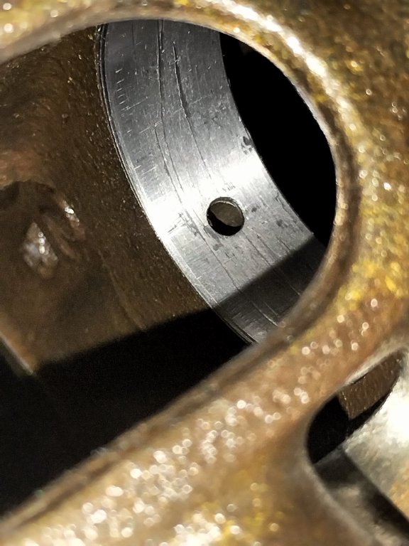

Also loo at the damage the done to the cam bearings which were brand new Clevite Malhe.
Make ones blood boil.
