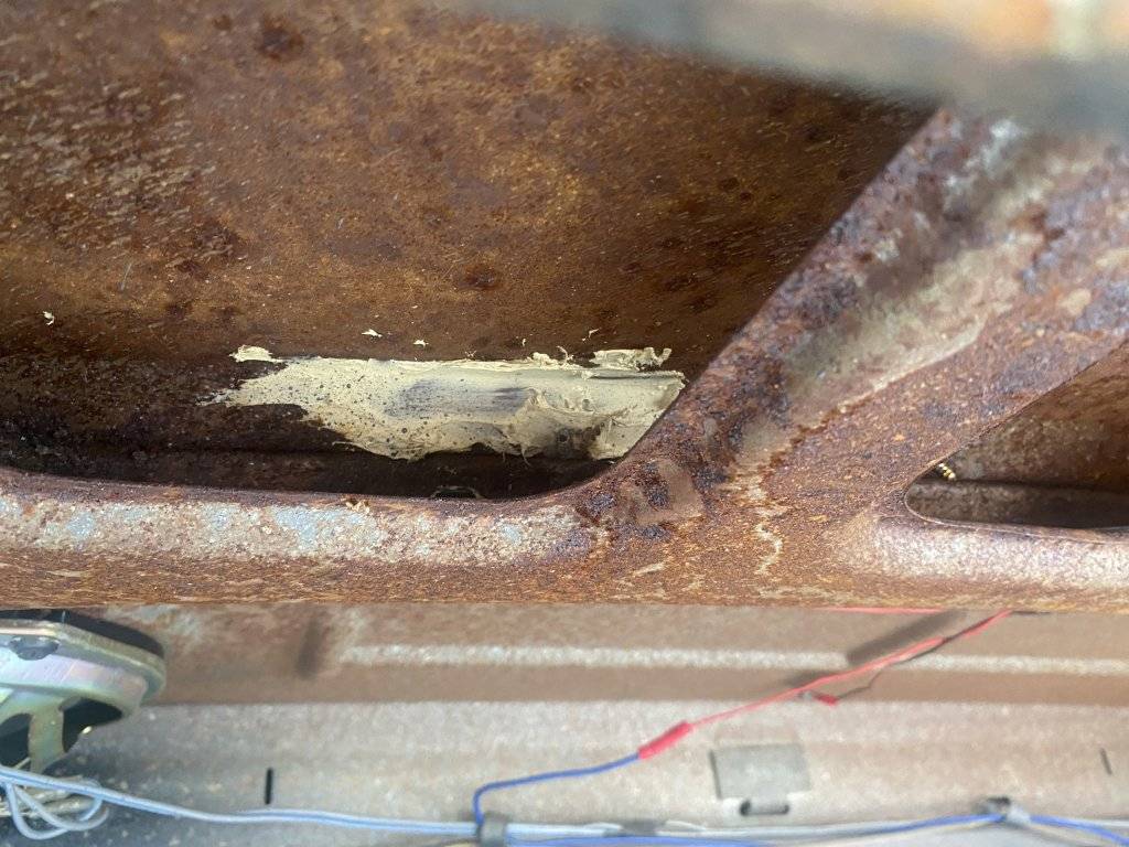

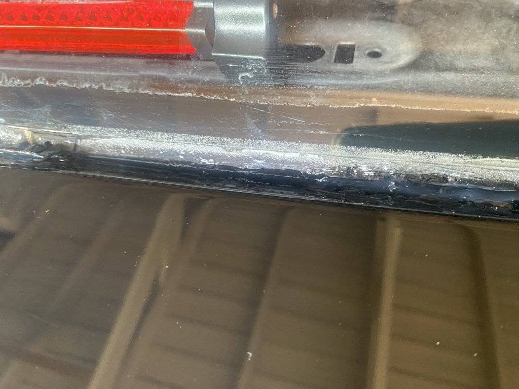

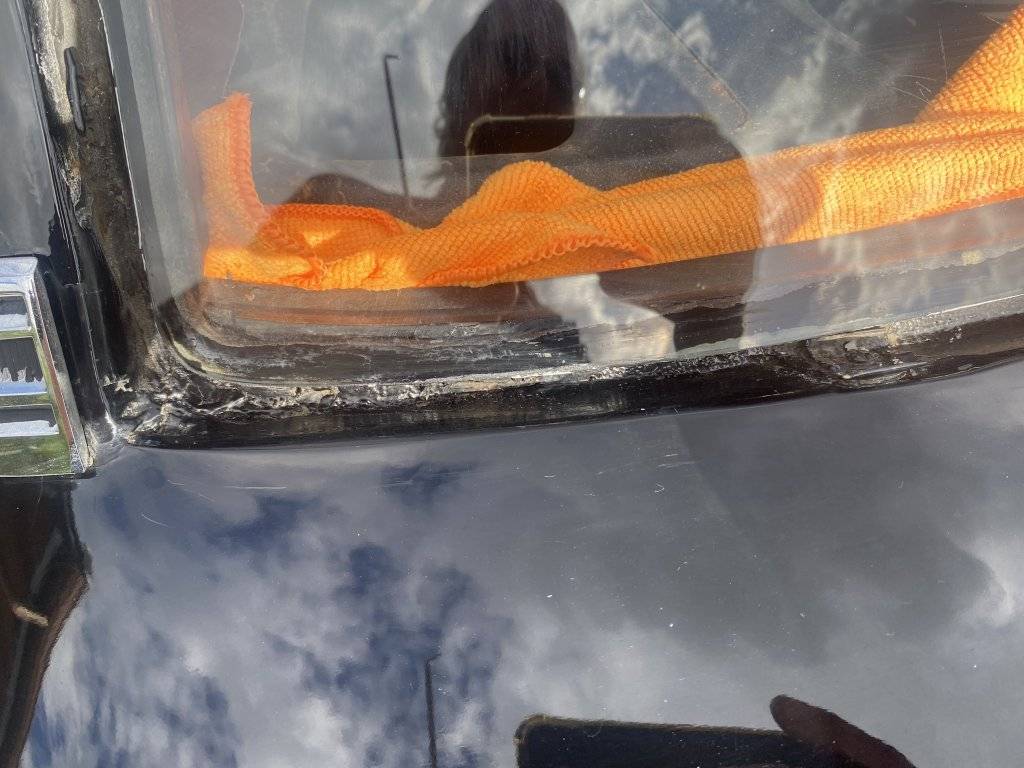

So, after many months of speculation, I've now confirmed that my rear window leaks water into the trunk. What to do?
I can see that someone, at sometime in the past, did some sort of repair to the seal, as some black rtv-like substance can be seen, but no other details are available.
I'm guessing that I need to remove the stainless steel trim, and then use something like a clear windshield RTV sealant, or perhaps the black 3M weatherstrip adhesive to go over the seam between the glass and the metal? Not sure how to proceed, but I know that many of you have been here before and know what the next steps are. Thanks in advance for your advice!

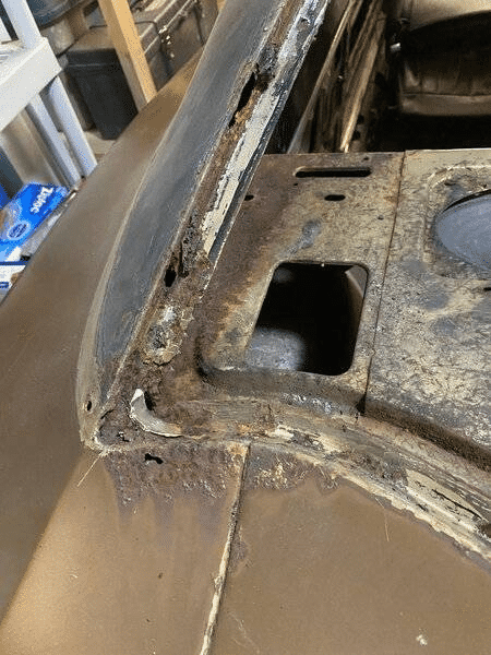

Me I would pull the window and see if the metal lip is still there. Common rust spot. Sucks though....
There have always been the "flowable" sealers which are applied with a flex-shaft nozzle, usually between the glass and gasket. I'm not sure that works as well as it is billed to, from our experiences on another vehicle we have with gasketed glass. So determining if the water is coming from between the gasket and the pinchweld or the glass and gasket, or combinations thereof.
As to sealer, I would prefer the genuine, premium 3M glass urethane-style sealer. To me, if the flowable sealer can flow into nooks and crannies, it can also flow out of them with time? Just my theory.
In using one of the sealers, be sure to install it for a ways away from where the actual leak might be. especially if there might be a low spot involved. You want to stop the main leak, but also prevent moisture from seeping in from other adjacent areas, too.
In the mean time, find some black strip caulk and put some in the places where the glass touches the gasket and where the gasket touches the body. That could be s diagnostic shorter-term fix. A few popsicle sticks and/or similar round dowels with a tighter radius on their pointed end can work to tool the caulk into the gaps nicely.

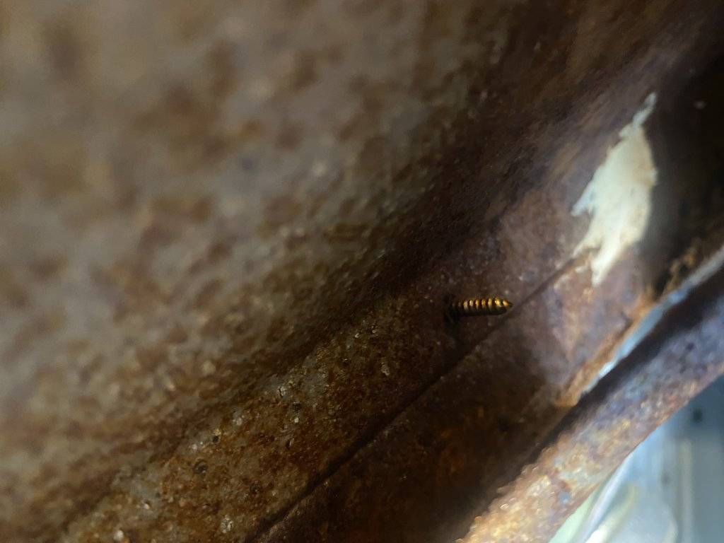

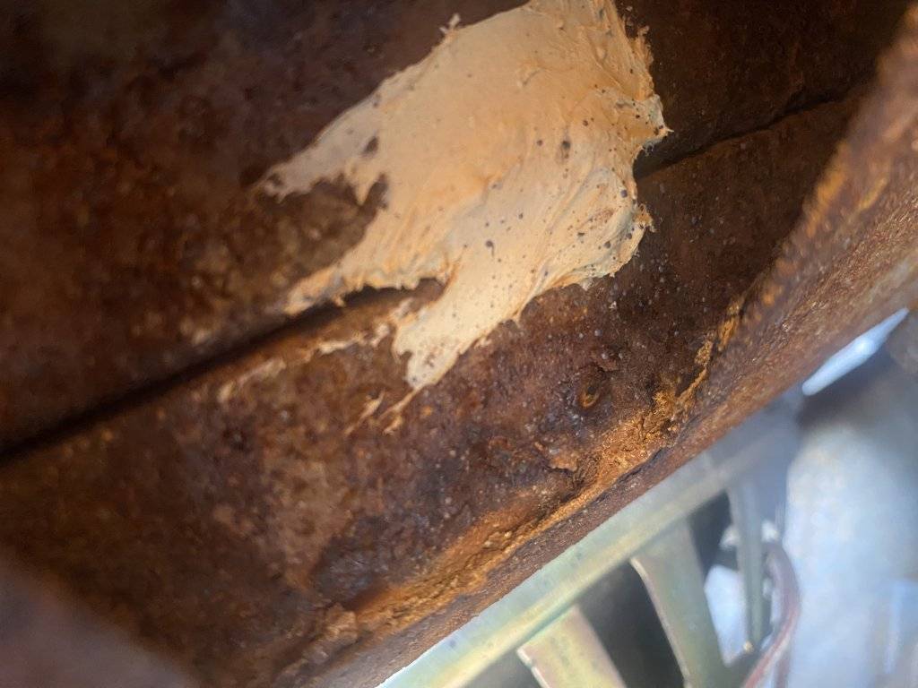

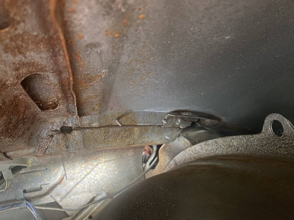

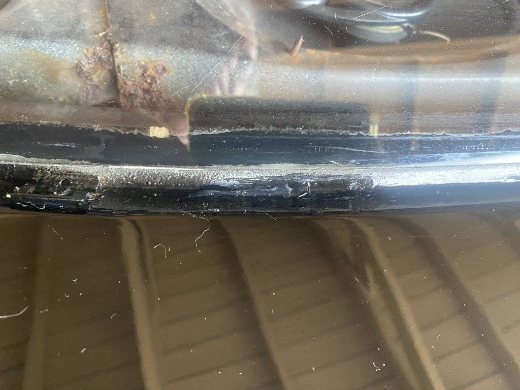

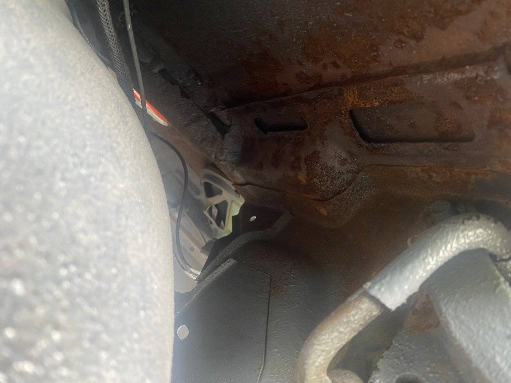

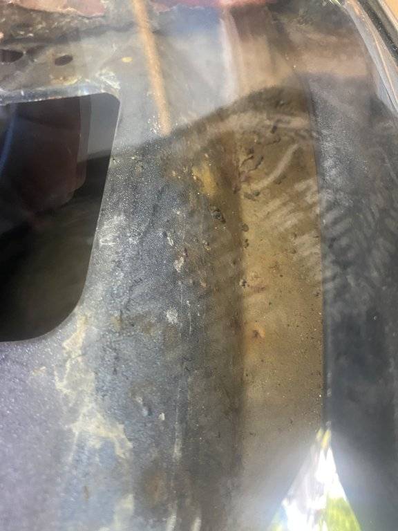

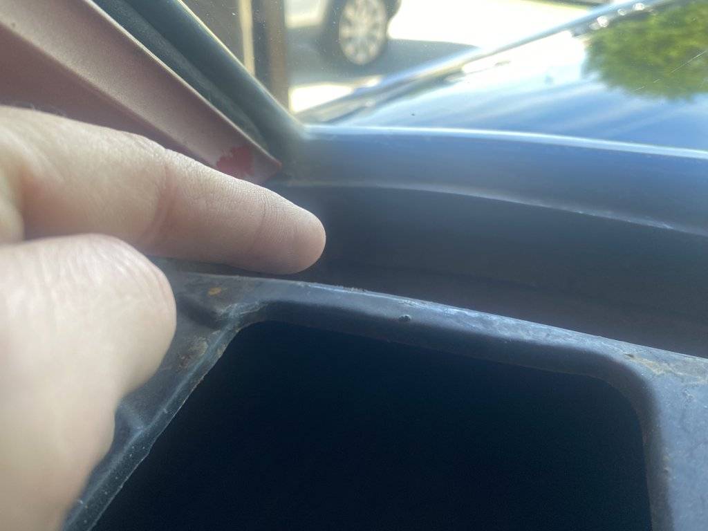

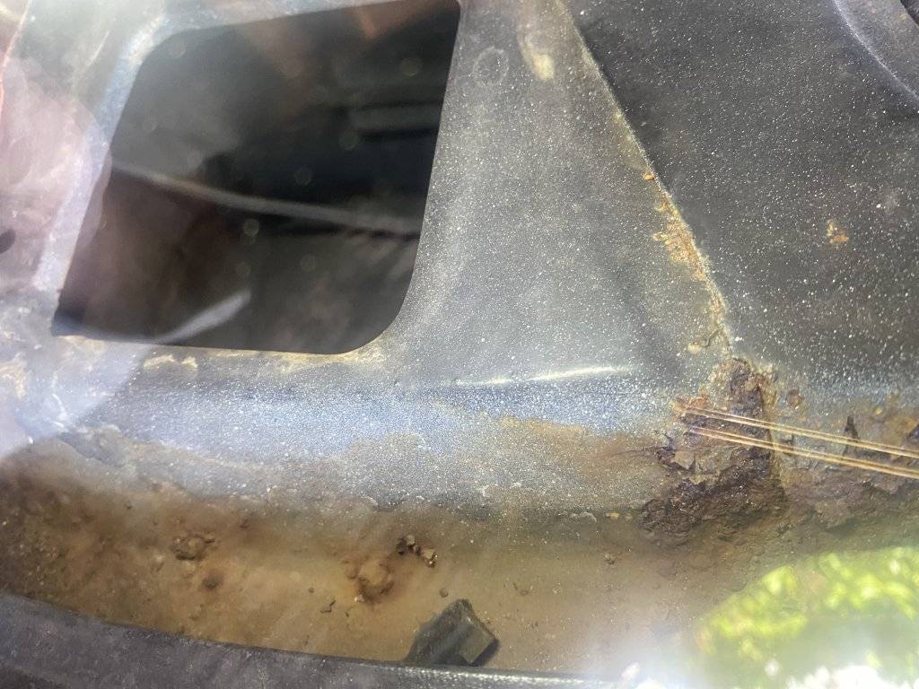

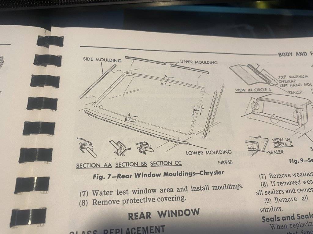

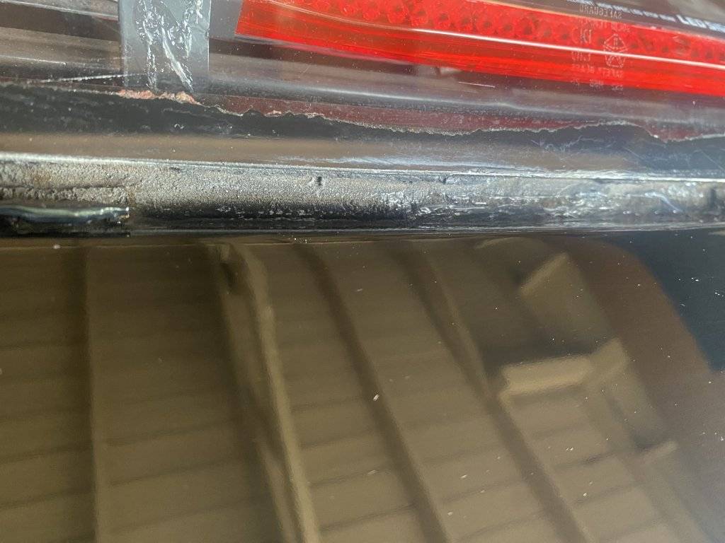

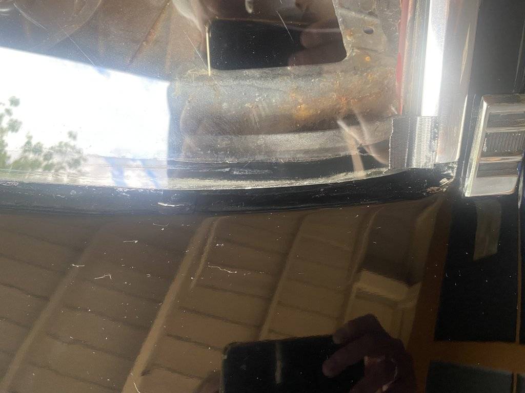

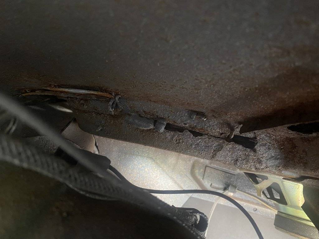

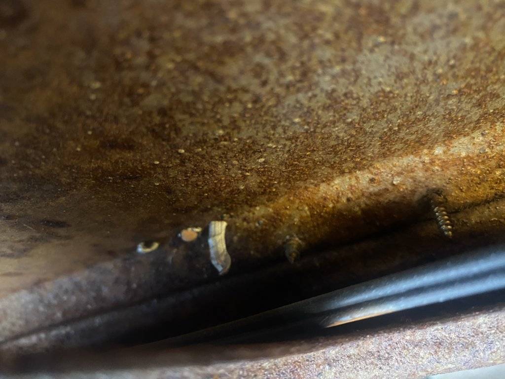

I watched the “new features for 66” video on YouTube where they talk about the new design of the rear window seal. Looking at the diagram in the FSM I really don’t understand how it all is supposed to go together and work. The water is going under the seal and into the vehicle, pooling up on the package shelf before it drains into the trunk. You can see where I’m pointing in the pictures below. I had a hard time getting clear pictures without glare, so my apologies for that.
My 65 SF rear window had some mild rust issues (same rear glass/gasket as you have).
I've had good luck with this, it goes on wiht a small paintbrush (you supply it, IIRC it's not a brush-in-can).
BUT - you'll need to decide if removing the rear glass/gasket and cleaning/painting the metal pinchweld is a better plan.
This will also allow you to replace any trim-clips that are in poor condition.
But the biggest thing -
If you try to get sealant around the gasket while there is still a bunch of crud in there, you are asking for a poorly-sealing repair. It might actually trap moisture.
That stuff also often interferes or does not flow well around the clips anyway and/or can interfere with the trim installation.
If the trim hasn't been off for awhile, you'll find it pretty stubborn. There's a special tool for these clips, but I've found (on 3-4 different cars) that each clip might require its own technique/tool. Often you won't know what that technique is until the clip pops and the trim is free. Squirting WD40 under the trim at the clip might help a bit?
